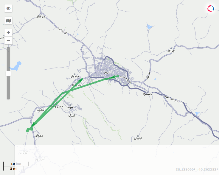

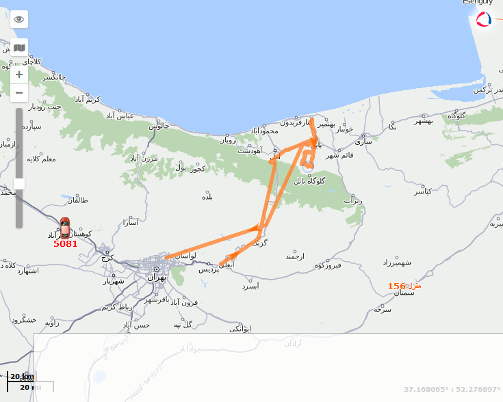

Hi there
We faced a problem with last version of WiaTag. We set data collection to continues mode and data sending continues mode. But, the application doesn't send data automatically. collect data and store in black-box and user have to press black-box unload button.
If other partners faced same problem please share here.
Gurtam guys please check
81
WiaTag
(edited by Pavel Bushuyeu 30/05/2017 11:03:36)
Re: WiaTag
Hi hhamedk
will check and come back to you
UPD: the bug is confirmed

hhamedk wrote:
Hi there
We checked all data sending modes and found the issue only in the "By timeout" mode on devices with Android 7.0+. Fix will be available in the next update as soon as possible.
If you found issues in other modes please contact us to development@gurtam.com with log files.

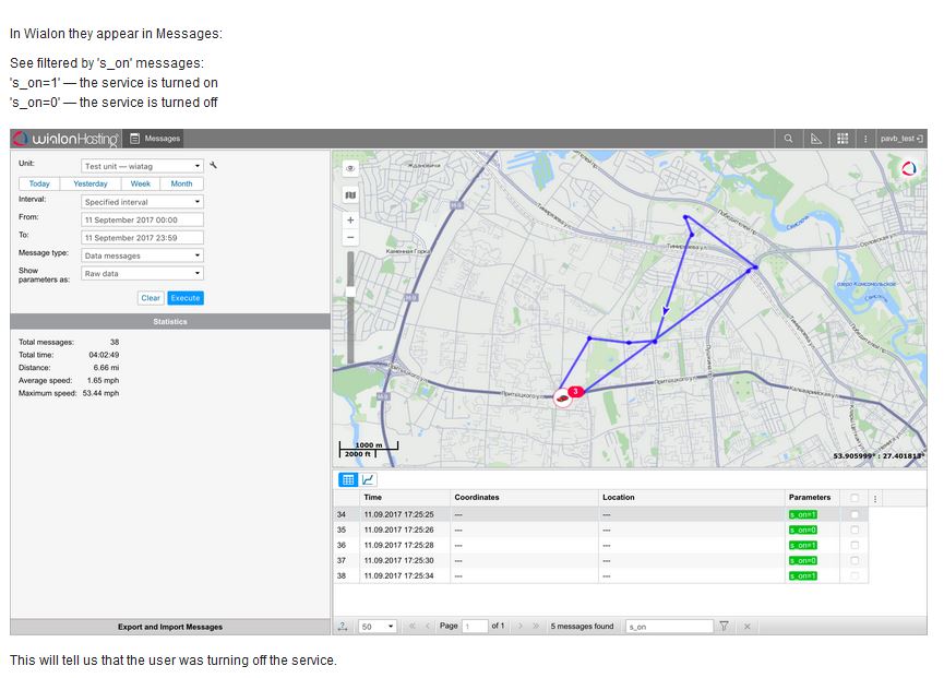

Hi there
May Gurtam add a parameter as an extra parameter in WiaTag to check if location source On/Off. When this parameter changes put it to message and send to Wialon. This way we can find when the user turned on/off GPS (location service). This will help as Mock Location helps us now.
Re: WiaTag
hhamedk wrote:
Hi there
May Gurtam add a parameter as an extra parameter in WiaTag to check if location source On/Off. When this parameter changes put it to message and send to Wialon. This way we can found when the user turned on/off GPS (location service). This will help as Mock Location helps us now.
Yep. And additional warning if service was disabled (this can be done if app was not closed) and also if app was killed (you can use a physical cookie on android to detect that). So for Error finding and telling the client "ok guys, if your employe switch off the GPS or disable the service, or Kill the app in taskmanager you dont need to blame us for it"
Best regards
Wolf
Re: WiaTag
hhamedk, wwbusch aka Buwo
Hi Hamed, Wolf,
At the moment we are sending messages when we get a new location or user sends a photo, position, SOS, QR code or NTS-pay. Hence, the logic of sending a message when the location services are changing their state, or the application is closed is not supported in WiaTag at the moment. We will add the request to the backlog, however, please be informed that we aim to keep iOS and Android apps coherent to each other and the proposed solution does not solve all workarounds that end-user may do in order to stop location tracking or app usage. Hence, that is a matter of debate if we are to implement the requested feature. As noted earlier there are certain pre-assumptions that OSes have that limit our involvement in what the end-user may do with her cellphone.
Pavel Bushuyeu
Product Owner, Mobile
Gurtam
Re: WiaTag
Hi Pavel,
i know its complicated. But real live shows that people disable it and boss complains that WiaTag is not working at all.
--> if you experience this a few times, you can
- Ask for a way to show your customer that his employee did made a fault (thats what we are doing here)
- dont recomend Wiatag (hmmm, not what we want)
- choose another product for this user case. (hmmmm. not what you want :-)))
CU in Minsk
Wolf.

1. Service status parameter
Service parameter will come in the message when the user turns on or turns off the service:
WiaTag
In Wialon they appear in Messages:
See filtered by 's_on' messages:
's_on=1' — the service is turned on
's_on=0' — the service is turned off
WiaTag
This will tell us that the user was turning off the service.

Hi everyone
I have problem with wiatag on our costumer device
The device is samsung galaxy j7 with 6.0.1 android
I tested everything.
I tried different user mode setting.
I changed device location source
I checked device maintenance
but didn't work
  • WiaTag
  • WiaTag
Re: WiaTag
Hi ashkannekokar.official
Please, contact support@gurtam.com for the further investigation of the issue. Thank you.
Pavel Bushuyeu
Gurtam

hasan.ahmed wrote:
thanks, it worked perfectly
another question
i read the release notes of wia tag there was this update
Turning on and off the application service and crash report are added to the Status Messages
what are the  Turning on and off the application, crash parameters that is sent to the server
This is a quote from WiaTag documentation.
Service messages. When this setting is selected, the message contains the following parameters:
service status (s_on=0 — disabled, s_on=1 — enabled);
unforseen service shutdown (cr=1).
Sent messages also contain the parameter 'ls', the value of which depends on the selected location source
detector:
ls=3 — when GPS, Wi-Fi and mobile networks are used;
ls=2 — when Wi-Fi and mobile networks are used;
ls=1 — when GPS is used;
ls=0 — when location services are off.

i have wiatag installed on a Samsung tablet,
i deleted the iemi and created a new unit with the device iemi then i pressed send location several times the tables shows position sent message,but there is nothing in wialon.
i cleared the second unit iemi with zero messages received in wialon and created a third unit,same thing happened so i returned to the original unit and set the iemi to it.
after about 15 min the created unit received the messages that belong to it,after a wile the other unit(3rd) recieved the messages ,a and later the original unit recived the messages that it belong to it.
there was a time delay or shifting
any explanation
