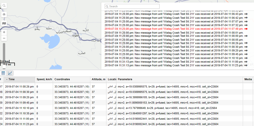

i have the wiatag sending a position with Altitude, m = .....
what could be the reason?
157
WiaTag
Re: WiaTag
Altitude is one of GPS parameters in 3D positioning so it's normal that each GNSS module calculate it's Altitude.
