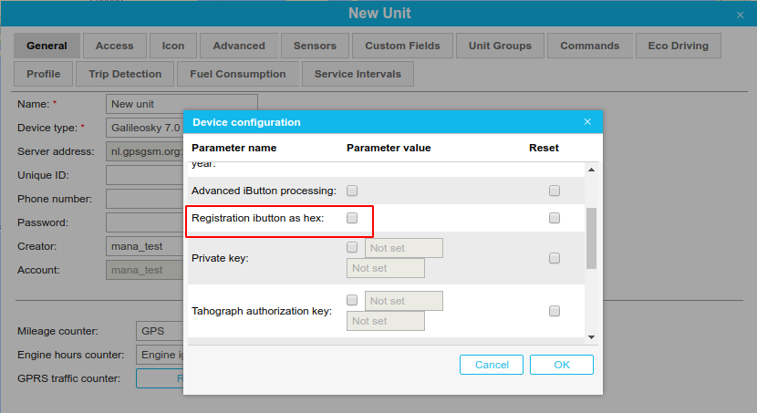

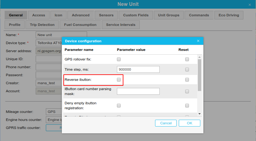

If I understand you correctly, your driver has one iButton, which is used for two different trackers (Teltonika and Galileosky).
In this case, you can try to use the following checkboxes in the device settings:
- registration ibutton as hex for Galileosky tracker;
- reverse ibutton for Teltonika tracker (see screenshots).
If you have any questions about this, please, send me unit example in private message.
