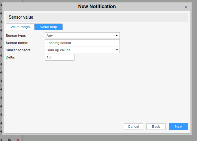

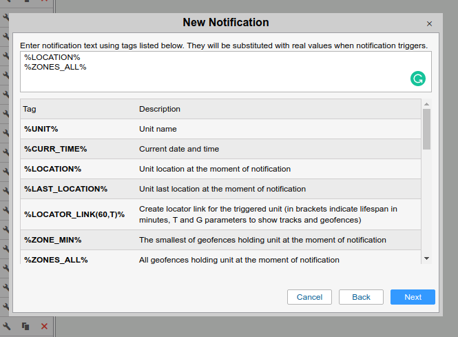

1. Create notification with type "Sensor value (Value leap)". Choose a sensor and set the value, that detects loading or unloading. You can choose different actions, but the main is to set in the notification text parameters %LOCATION% and %ZONES_ALL%.
When the notification triggers, you will have the information where loading/unloading was held and if the geofence is already created.
2. If geofence is not created yet then go to the Geofences tab and create a new geofence-circle with coordinates, taken from notification text. For more convenience, you can add it to a group.

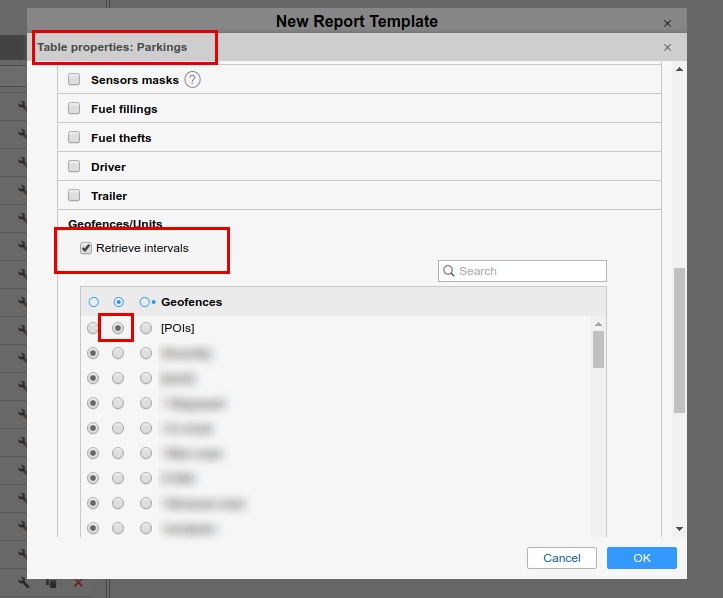

3. Create a report "Parkings" for a group of units. Choose the group of loading/unloading geofences in settings.
That is how you'll get the duration of loading/unloading.
I do not recommend creating geofences automatically, as you may have a lot of duplicates. After that, you should add all these geofences to the report template manually. If you have duplicated zones, then you might get duplicated data.
