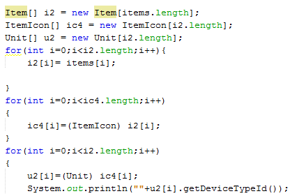

Hello kopa.
I use this dataFlag but i can't get data Unit. I don't know if this is an error because i'm trying with all dataFlags
I hope your comments.
Thanks!
Here is the code
Desarrollo Please check access type for token, which you use.
Parameter access type
Value Description
0x100 online tracking
0x200 view access to most data
0x400 modification of non-sensitive data
0x800 modification of sensitive data
0x1000 modification of critical data, including messages deletion
0x2000 communication
-1 unlimited operation as authorizated user
(allows to manage user tokens)
http://sdk.wialon.com/wiki/en/sidebar/r … cess_flags
http://sdk.wialon.com/wiki/en/sidebar/r … rmat/token
Thank you so much!! I changed properties to generate token and its working!
