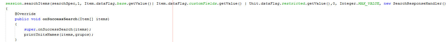

Hello Guys!
I'm deploy with JAVA API and i have a question, What is the dataflag that i need to get UniqueId, phonenumber1 and 2 ? , before the new update i used
Item.dataFlag.base.getValue() | Item.dataFlag.customFields.getValue() |Item.accessFlag.editImage.getValue()
Thoses apply correctly, but now only i have null data.
I hope your comments.
Thanks in advance!
Desarrollo Hello. You can get unit's unique id and phone number by Unit.dataFlag.restricted data flag.
Hello kopa.
I use this dataFlag but i can't get data Unit. I don't know if this is an error because i'm trying with all dataFlags ![]()
Thanks!
Here is the code
Desarrollo Please check access type for token, which you use.
Parameter access type

Thank you so much!! I changed properties to generate token and its working!
