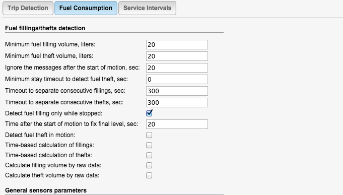

Can someone recommend what should we set in Fuel Consumption > Fuel Filling / Theft detection to get the accurate reports ? We are using an analog FLS sensor.
See my current settings for the Device ,
Thanks

Sorry ,
See attached.

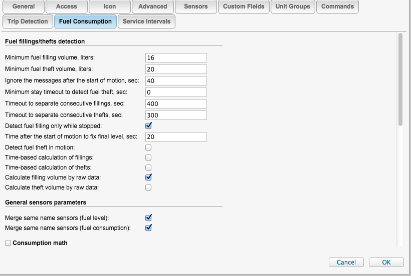

This is another one
  • Best Practise Fuel Consumption Settings

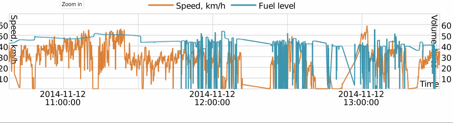

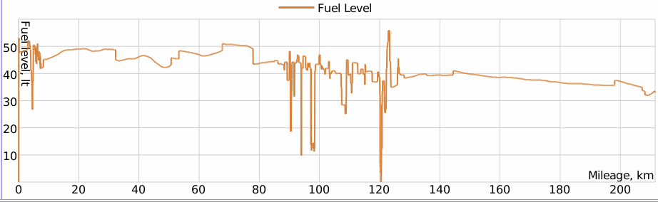

analog fls should not jump so much. maybe you can switch off filtration and post a chart here with the time frame where it jumps so much?
Wolf.
Re: Best Practise Fuel Consumption Settings
Hi Wolf ,
Please see the screenshots.

hm, looks very strange. on first graph you have some times where it is always jumping to 0.
is there really a 0 value in the raw data? did you check that? analog fsl should not send 0 as voltage, looks for me that something wrong with the sensor or the reading... what HW tracker do you use?
and than it looks so that you send very often some data... how often? every xx minutes?
but for sure that can be fixed. weather you supress some data or you do different filtering, there will be a way...

wwbusch aka Buwo пишет:
Wolf, You are not correct. All depends from sensor. How many fuel sensors You have installed?
BTW: Graph is realy very strange. Possible to get access to this object on server for settings?

It seems that this is FLS problem. Depends on the FLS type and manufacturer it can be caused by water in the tank or a simple cable connection problem. If you want a fast improvement, then you can set "X lower bound"  (Unit properties>Sensors>your FLS sensor properties>Calculation table). Here you can set a value higher then 0 and lower then the FLS's measuring range's bottom point. (for example if your analog range is between 200 and 4000, then you can choose a value between 0 and 200..)
This will filter out the wrong (decreasing to zero) values (it only hides the real problem..but working).

Thanks guys , WOW lot of good advices , yes I checked the messages  there was value 0 , it took 2 days for the customer to send the vehicle to us , once we checked , found out  there was a problem with a wire hmm ,which had happen during vehicle's maintenance work. We have fixed it and will test for next 5 days then update with the outcome.
