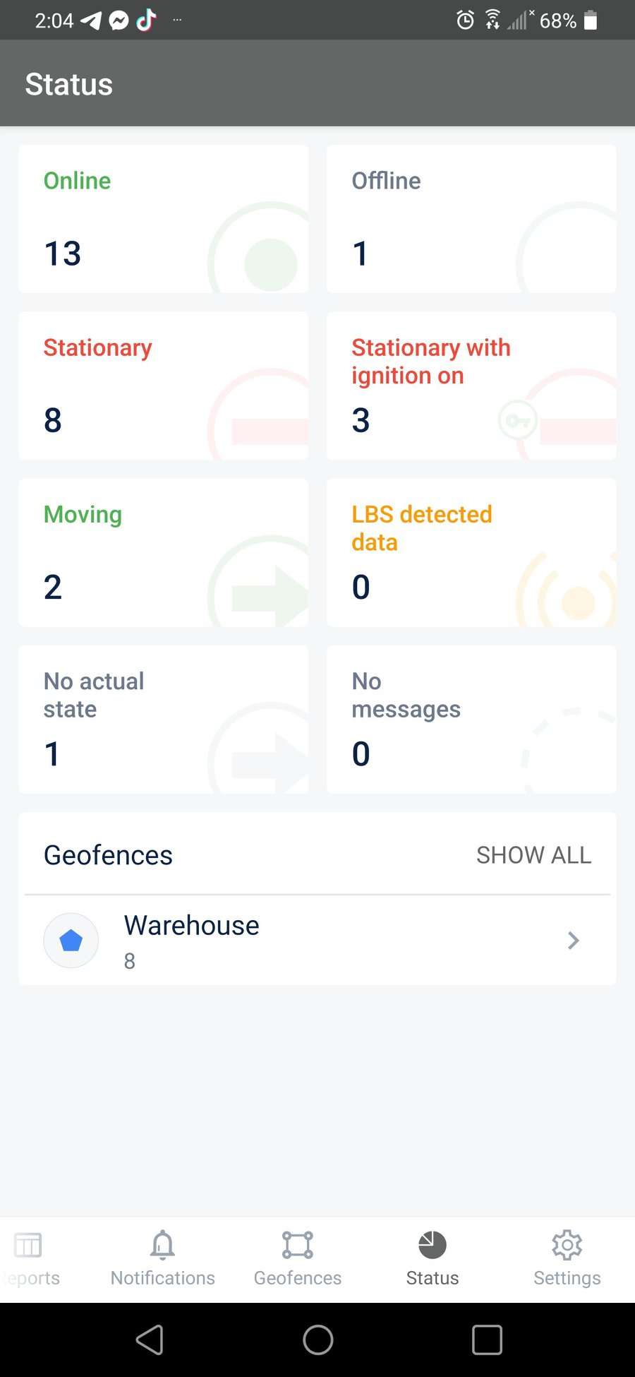

2. Could you advise me how to get all vehicle status as below:
  - Online
  - Offline
  - Stationary
  - Stationary with ignition on
  - Moving
  - LBS detected
  - No actual state
  - No Message

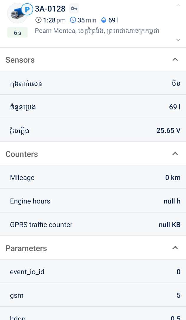

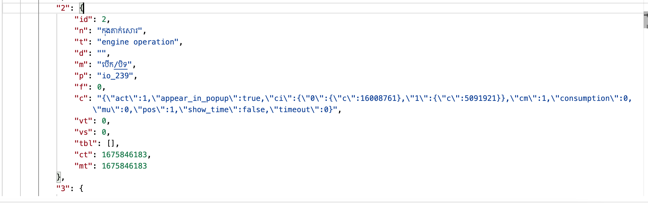

3. How to get Sensors status as below :
   - Ignition
   - Amount of fuel
Please kindly to check my attached file

chanden good day.
1. You can only get a coordinates with last location of the units. You need to add flags value of 1024. Then you can use coordinates into [code=https://sdk.wialon.com/wiki/en/sidebar/remoteapi/apiref/requests/address]gis_geocode[/code] request as pet the [code=https://sdk.wialon.com/wiki/en/sidebar/remoteapi/codesamples/address_coords]example[/code].
2. Most of the data can be received via search_items or search_item requests.
Online/Offline state regulates with 2097152 flags
Stationary/Moving state can be determine as per the speed value in the last message. Flag 1024
LBS detected, No actual state, No Message -- presumably, these states you can check requesting lat message with corresponding [code=https://sdk.wialon.com/wiki/en/sidebar/remoteapi/apiref/messages/load_last]request[/code].

3. In order to get sensors values, you can use two different options:
- Via [code=https://sdk.wialon.com/wiki/en/sidebar/remoteapi/apiref/unit/calc_last_message]calc_last_message[/code] request. The reply shows sensors values from the last message by the sensors ID. In order to determine sensor ID you can use search_items request with flags value 4096
- you can use [code=https://sdk.wialon.com/wiki/en/sidebar/remoteapi/apiref/events/events]events[/code] to control sensors states changes. This option describe in the [code=https://www.youtube.com/live/nUtNS5Al5wo?feature=share]webinar[/code].

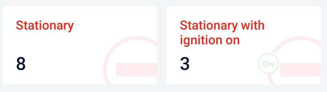

Dear zant,
Good day to you,
My problem not solve with stationary with ignition on .
Could you give an example how to count stationary and stationary with ignition on.
Pleas kindly check my attached file .
Thanks!

chanden hello, in order to determine such status you can control two values - ignition sensor value and speed value. Thus if the ignition is ON, but speed value is below minimum moving speed specified in the trip detector - this is stationary with Ignition ON.

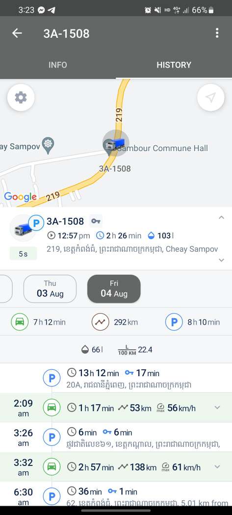

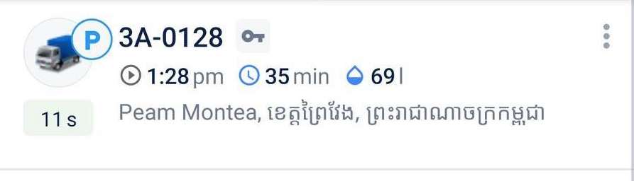

Is it possible to executing several commands API at once as below:
1.Parking
2.Count km
3. Km/H
4.Fuel
5.Route on map
Please kindly help to check my attached file
  • Unit Realtime API
Unit Realtime API
Re: Unit Realtime API
chanden hello, in this case you can try to use events. You need to add units into the session with required parameters. Then you can check updates of the events.
