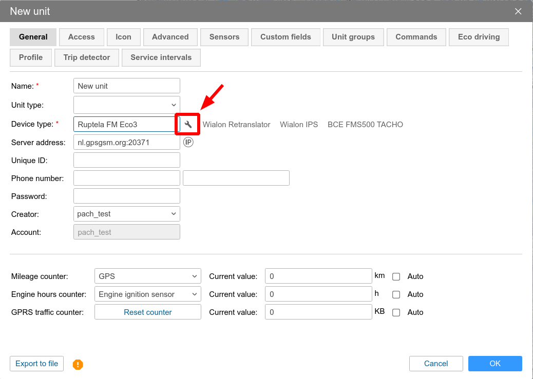

The menu is called Device configuration. Click a wrench icon in the General tab to access that menu:

But no exist option: "I suggest checking the configuration in the General tab of the unit's properties, and making sure the option «Revers format ibutton code as hexadecimal value» is unchecked (you may also activate the option «Format ibutton code as hexadecimal value»):"
What device type do you use exactly? Do you have your unit in Wialon Hosting or in your own Wialon Local?

This:
Wialon Local
Ibutton ID number conversion
Re: Ibutton ID number conversion
taliban wrote:
This:
Wialon Local
Please provide the exact model of the tracker that is installed in the unit you are referring to. You can also send a request to the support@gurtam.com with the details, so the support can check from their side if this option should be there or not.
