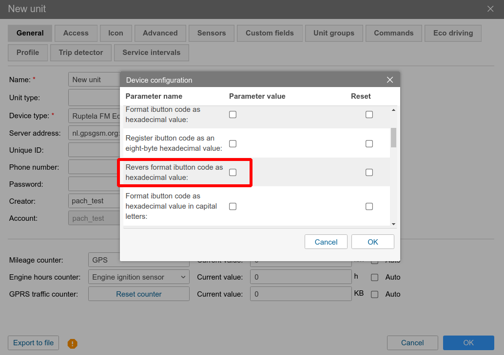

Concerning your current example, the 121698057262727288 is the decimal, that is calculated from the reversed hexadecimal value — 01B05BBD01000078. So, for some reason, the initial 78000001BD5BB001 value is reversed to 01B05BBD01000078 and then converted into the decimal value.
I suggest checking the configuration in the General tab of the unit's properties, and making sure the option «Revers format ibutton code as hexadecimal value» is unchecked (you may also activate the option «Format ibutton code as hexadecimal value»):

The menu is called Device configuration. Click a wrench icon in the General tab to access that menu:
