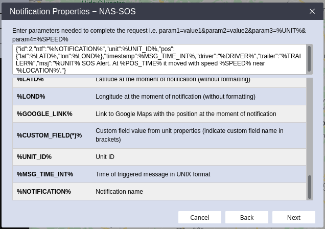

Thank you Dear Mapa, but I mean add the reource id in "the body" of the notification like wialon currently has the unit id. Please see the attached file.

Thank you for your clarifications, cerpas. However, we have no plans in adding such placeholder to the text of the notifications at the moment.
It will be much faster and easier for you to use the API for notifications that contain resource id (the link from the previous message).

Thank you for yout feedback use the API is really hardcoding (specially for routes and geofences), but I guees that I will append a notification generator in my app or something like that.
