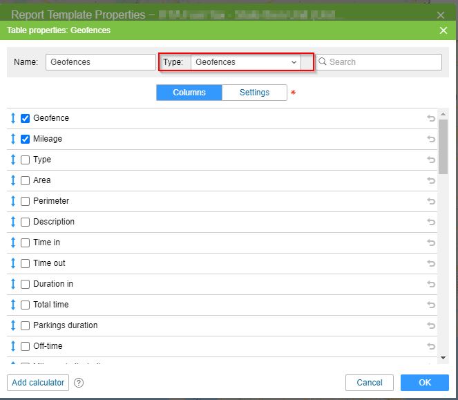

Also, on your suggestion, I do not see an "Address" column available in the Geofence report. Would that column possibly be named something else?
I want you also know that we have previously received request which may solve the problem you face at the moment. It was requested that when the option "Use geofences for addresses" is enabled - the address is not fully changed in the "Address" column, and both the address and geofence should be added as separate columns in the report. Let me know if that solution will suit your needs as well.
Feature Request - Geofence Report with Initial Location Included
Re: Feature Request - Geofence Report with Initial Location Included
ATalledo,
At the moment we have no plans in adding the requested improvement.
The specified setting is available for all tables within the "Unit" and "Unit group" types of reports. Thus, you could use it for the Geofences table of the Unit type of the report. Please see the setting in the screenshot: the setting is available in the Settings tab of the whole report template - under the Address separator.
It is not available for the Geofences type of the report, though.
