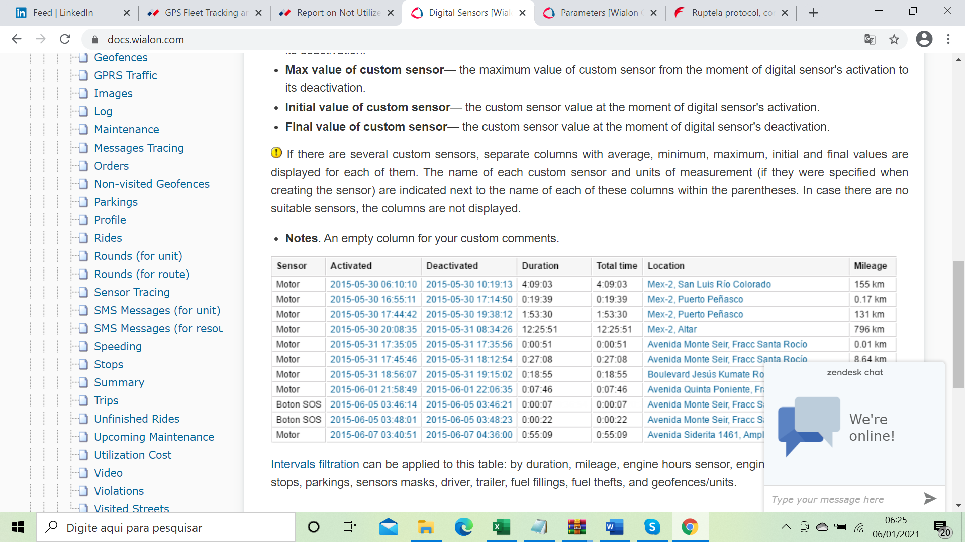

The logic solution to this problem it's look similar:To control the time of the vehicle was in maintenance it's necessary specify the  time that the igntion was on and off and compute the difference,if the value it's to large could be  necessary compute the time that the ignition was off (at the counter parameter it's the current date+1 day).
It is not possible to create such parameters by Wialon. Parameters are sent by trackers, and some devices can have a built-in logical algorithms to count something like you need.
"Still it is possible to display in reports the data you requested. Some possible solutions were already mentioned in previous messages. Here is one more:
1. Create ignition sensor with a name "Engine status" (that's just an example).
2. Create a custom digital sensor with a name "Engine is off" and formula: const1-[Engine status]
3. Use table "Digital Sensors" to display duration of active sensor status.
    Don't forget to set a sensors mask "Engine is off" to show only this sensor. To filter minimal duration of 3 days use "Min duration" option.
    Both of mentioned options can be found in intervals filtration in table settings."
https://forum.gurtam.com/viewtopic.php? … 25#p186725

Thank you very much for explanation and ideas how it can be made. It became much clear.
