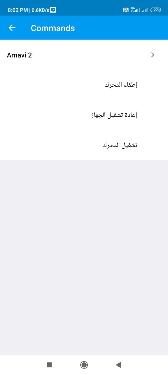

Hello!
How to execute a command for different requests
With search_item API we got different command and each command have different execution, on which flag we set a condition to user selection
core/search_item&params={"id":29916,"flags":512}
    "item": {
        "cmds": [
                "n": "إطفاء المحرك",
                "a": 1,
                "t": "tcp,gsm,vrt",
                "c": "custom_msg",
                "p": "Out 1,0"
                "n": "تشغيل المحرك",
                "a": 1,
                "t": "tcp,gsm,vrt",
                "c": "custom_msg",
                "p": "Out 1,1"
                "n": "Arnavi 2",
                "a": 1,
                "t": "tcp,gsm,vrt",
                "c": "custom_msg",
                "p": ""
                "n": "إعادة تشغيل الجهاز",
                "a": 1,
                "t": "tcp,gsm,vrt",
                "c": "custom_msg",
                "p": "reset"
    "flags": 512
1) Sent message option to execute a command
2) Reset option to execute the command
3) simple Execute commands
How i can differenciate this response value of t,c and p for different units,
svc=unit/exec_cmd&params={"itemId":55873,"commandName":"custom_msg","linkType":"tcp,gsm,vrt","param":"","timeout":10,"flags":0}
