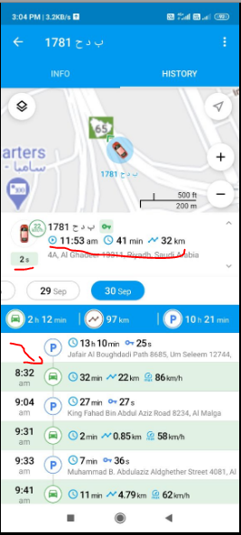

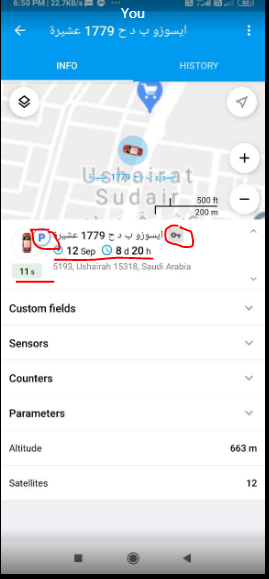

Hello Team
How i can get the attached screenshot details from the item search API
http://gps.tawasolmap.com/wialon/ajax.h … mp;params= {"id":20646,"flags":4611686018427387903}&sid=96d4c9e77d385ddf775f64d3c5dbd85b
As i have thought as per below please correct me if i am wrong
1) Name of the Unit                    items[0][nm]
2)Unit id                                      items[0][id]
3)Unit Latitude                            items[0][pos][x]
4)Unit Longtude                        items[0][pos][y]
) Speed of the Unit                     items[0][pos][s]
Date of last active
Engine status (On/Off)
Unit is in the parking or not
Last speed
How i can get from the above API if you
  • How to get Unit Last update date and time

as I got below response with once I follow the above steps 1 and 2 and below response I got
I got ignition and trip array,
how I can get value under the unit image "11s"
Date and time with speed
All the movement of the unit on the selected date

Last point that how I can get the movement of the units with start and [Between each] endpoint the day, or between dates

Hi, thanks for the update
If you can please help me to set the direction of the unit as i can see in the wialon app on the map each unit icon have a different direction, I am using google map to display unit
Re: How to get Unit Last update date and time
Good day!
To display direction we use the parameter course which device can send.
If your device type sends this parameter, you can get it from messages.
For example, pos: {y: 53.9058786, x: 27.4569481, c: 38, z: 302.700012207, s: 0, sc: 11}, where parameter 'c' is course , integer (from 0 to 359 degrees, where 0 - means North)

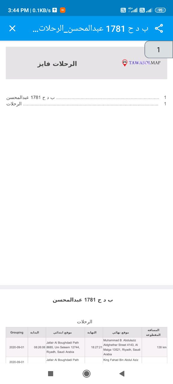

If you can please help me how i can get the report pdf file of the units same wialon App
1) Which API we can integrate to get all template to belong to the account
2) which API should help me to execute the report of the unit and in response get a pdf file with details of the movement with address
Please check I have attached two files
Hello!
1) To get all reports created in account via request search items or
search item by ID  with flags = 8193 ( base flag + 8192 reports data)
2) To execute report - please look example  https://sdk.wialon.com/wiki/en/sidebar/ … es/reports
3) After report executed you can export it to file - please look the request format here https://sdk.wialon.com/wiki/en/sidebar/ … ort_result
