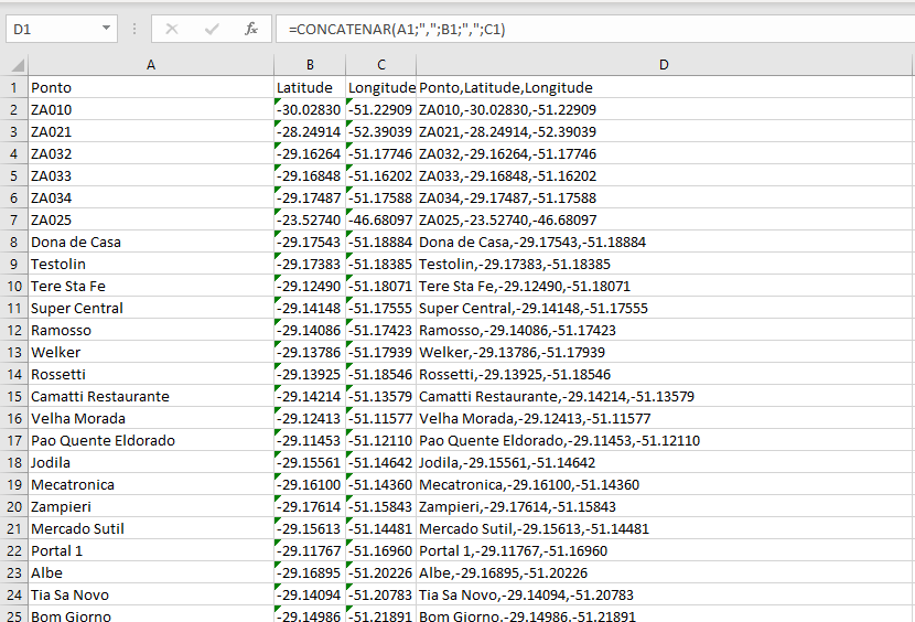

I needed to do this process today and I found a bit difficult, so I created some steps that can help other partners to do the same:
Create the locations inside Google Earth, export and import the archive in Wialon:
01) The first step is to have all the locations in excel with the titles:
Location    |    Latitude    |    Longitude
02) Use the formule: =CONCATENAR(A1;",";B1;",";C1) (CONCATENATE in english) in D1 and copy all the column D to a document .txt;
03) Import the document .txt inside Google Earth;
04) Export the locations in Google Earth to .kml;
05) Import the .kml file inside Wialon.
In case you need to change the radius:
01) Export geofences to .wlp;
02) Use notepad, in edit, replace: "w":1000, to: "w":radius;
03) Import geofences again.
