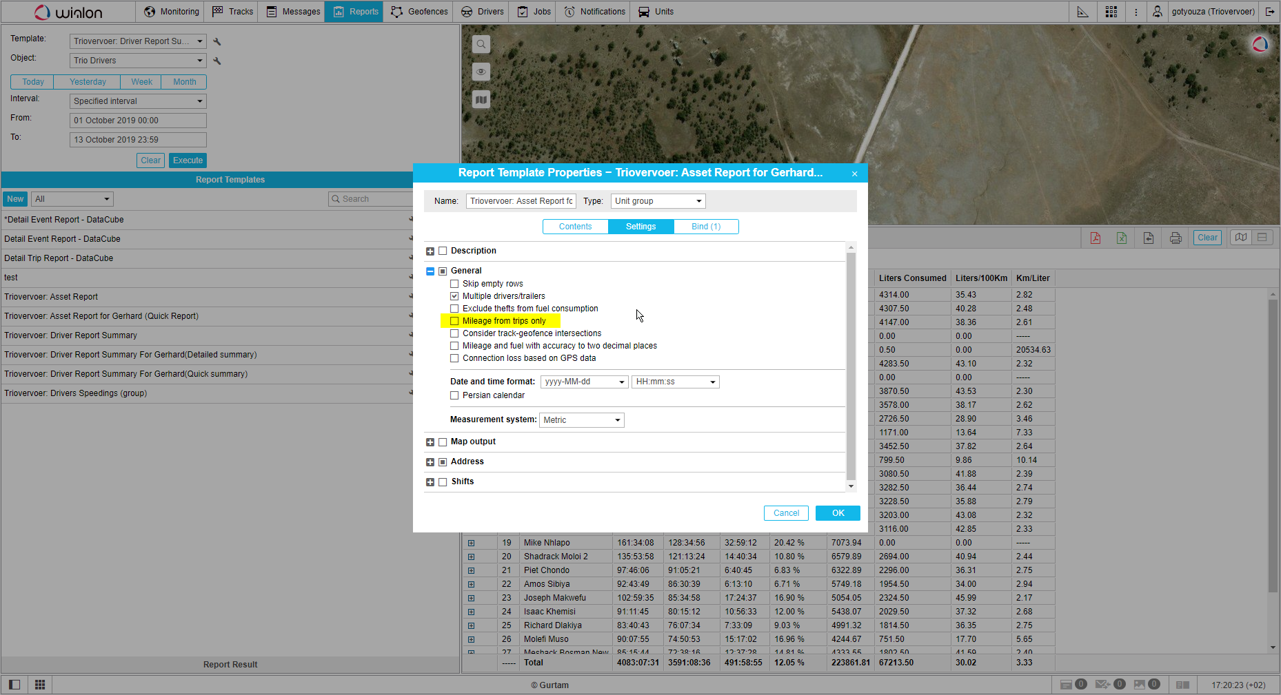

I would like to request that "mileage from trips only" be included in the driver binding report so that my asset and driver mileage match.
It should be logical that If my fleet drove 100Km, my drivers should also have driven 100Km..Not 130Km?
If "mileage from trips only' does not work, then I need something else to fix this issue.

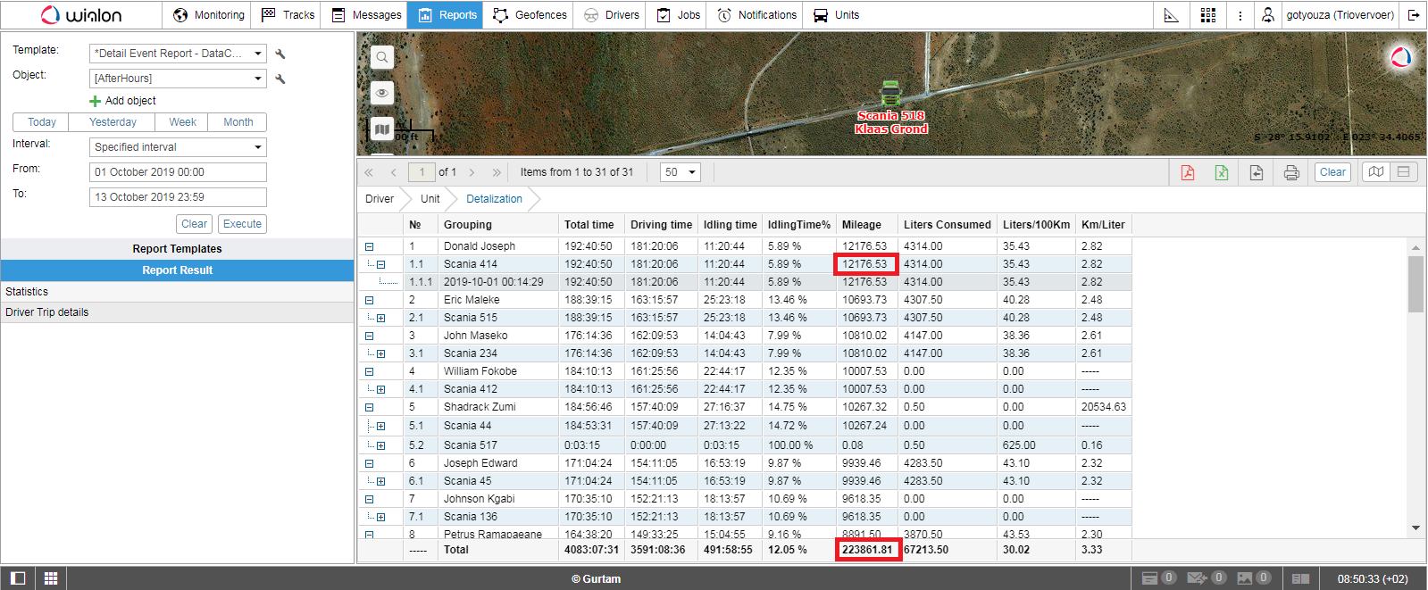

see screenshots - you will find that the total driving time, idling time and moving time are the same on some of the cells where only 1 driver was paired with 1 vehicle to compare but with different mileages.
