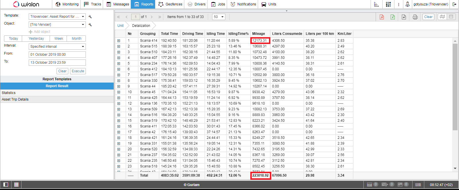

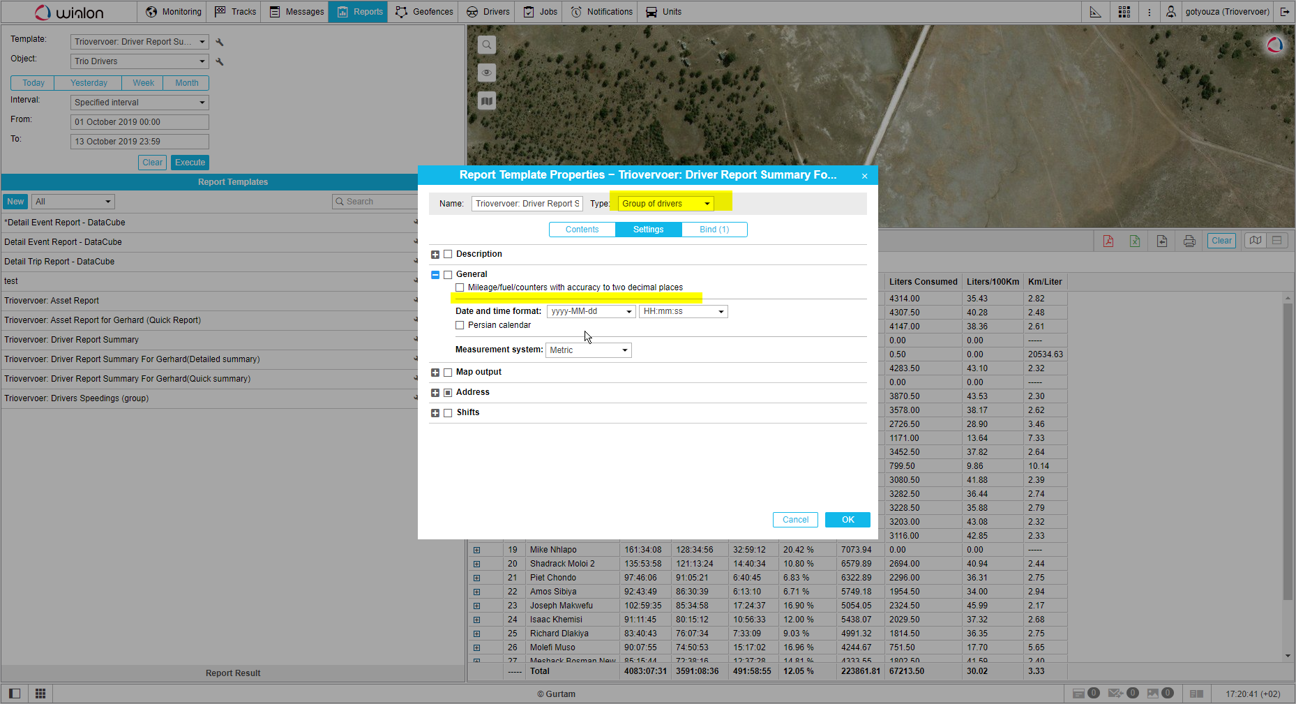

see screenshots - you will find that the total driving time, idling time and moving time are the same on some of the cells where only 1 driver was paired with 1 vehicle to compare but with different mileages.
