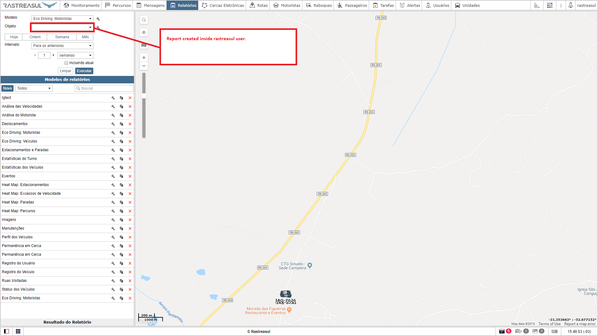

We’ve created a lot of reports inside Wialon in our admin user and we enable the access of the reports from admin to every user. We work in this way because we want that every client have reports updated and a lot of them.

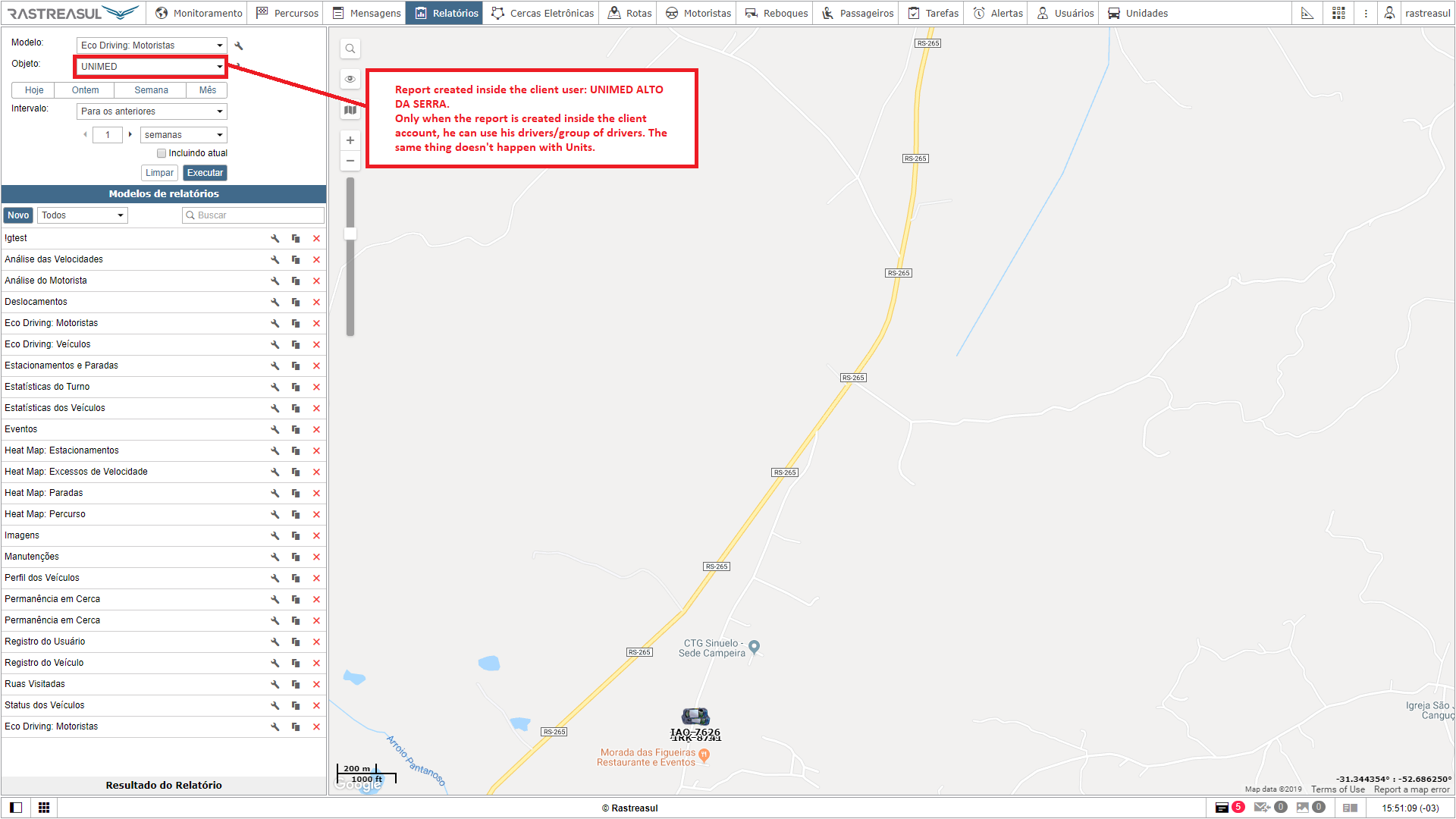

1. But we have a problem with reports of drivers and group of drivers reports: these reports works only for the clients users if the reports are created inside their users.

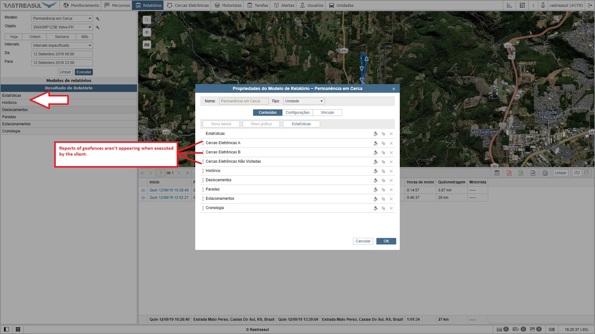

2. The same thing happens with geofences reports: when a report created by admin is executed by a client, the geofences reports doesn’t appear. Another thing that is a problem is that when a new geofence is created, we need to edit the report and select every new fence to be enable inside all the reports. I think that could have an option if any geofences weren’t selected, the report should be executed as if every geofence was selected.

A resource is a macro-element it works like a container for drivers, geofences and reports. That is why the work between different containers is labored and it is not possible to use a report template from one resource and driver from another.
Read more about object types in the documentation.
