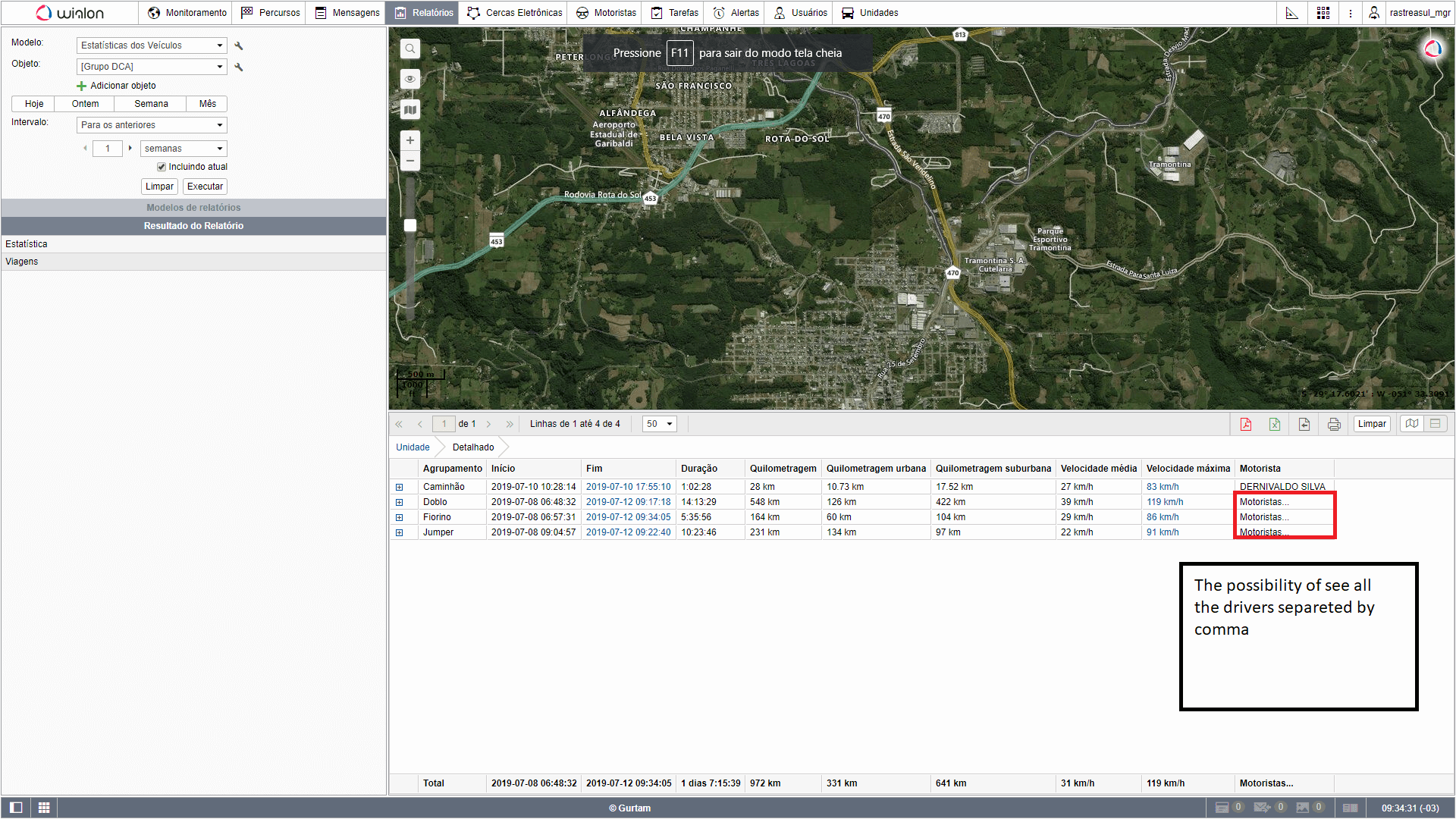

Good morning,
I have some suggestions for improvements in the platform.
01) Tool to reduce the opacity of the fences.
Some clients wants to draw overlapping fences, for example: A fence of his home, inside his city, inside his country. The most important fence is the first, so the opacity could be 100%, to stand out from the others fences, that could be at 50% and 20%.
02) Drivers in the reports should be shown
We have clients that use driver identification and they want to know fastly all the drivers that have been inside a car X in a day, week, according to the grouping.
03) Possibility of changing the duration of the working day and how it is detected, and calculate the meal time.
The standard time of working day here in Brazil is eight hours per day, so the way it is working on the platform does not work properly for us.
The way we are using the trackers for driver identification makes the driver be assigned to the vehicle until it changes to another driver, because the clients wants to see who is the driver, even if the vehicle is turned off, so the best way to calculate if he is working is if the engine is turned on in this case.
Would be nice too if there was a way to calculate the meal time of the drivers by selecting a period of wich the drivers generaly have their meal, the meal time would be selected in a screen of the parkings during this time selected or calculated automatically by all the parkings, to calculate the meal time of all the days.
Thank you!
