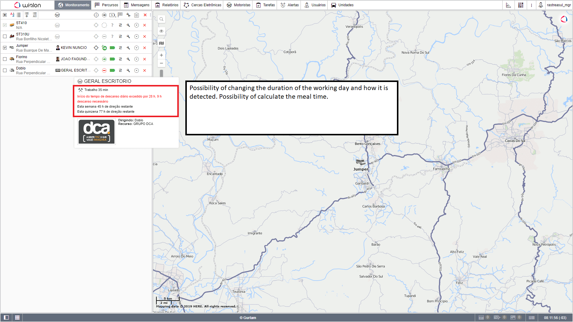

03) Possibility of changing the duration of the working day and how it is detected, and calculate the meal time.
The standard time of working day here in Brazil is eight hours per day, so the way it is working on the platform does not work properly for us.
The way we are using the trackers for driver identification makes the driver be assigned to the vehicle until it changes to another driver, because the clients wants to see who is the driver, even if the vehicle is turned off, so the best way to calculate if he is working is if the engine is turned on in this case.
Would be nice too if there was a way to calculate the meal time of the drivers by selecting a period of wich the drivers generaly have their meal, the meal time would be selected in a screen of the parkings during this time selected or calculated automatically by all the parkings, to calculate the meal time of all the days.

About the parkings, the platform could have a report (maybe in the tool in the screenshot) that you could set what was every parking manually, otherwise it would be just rest time.

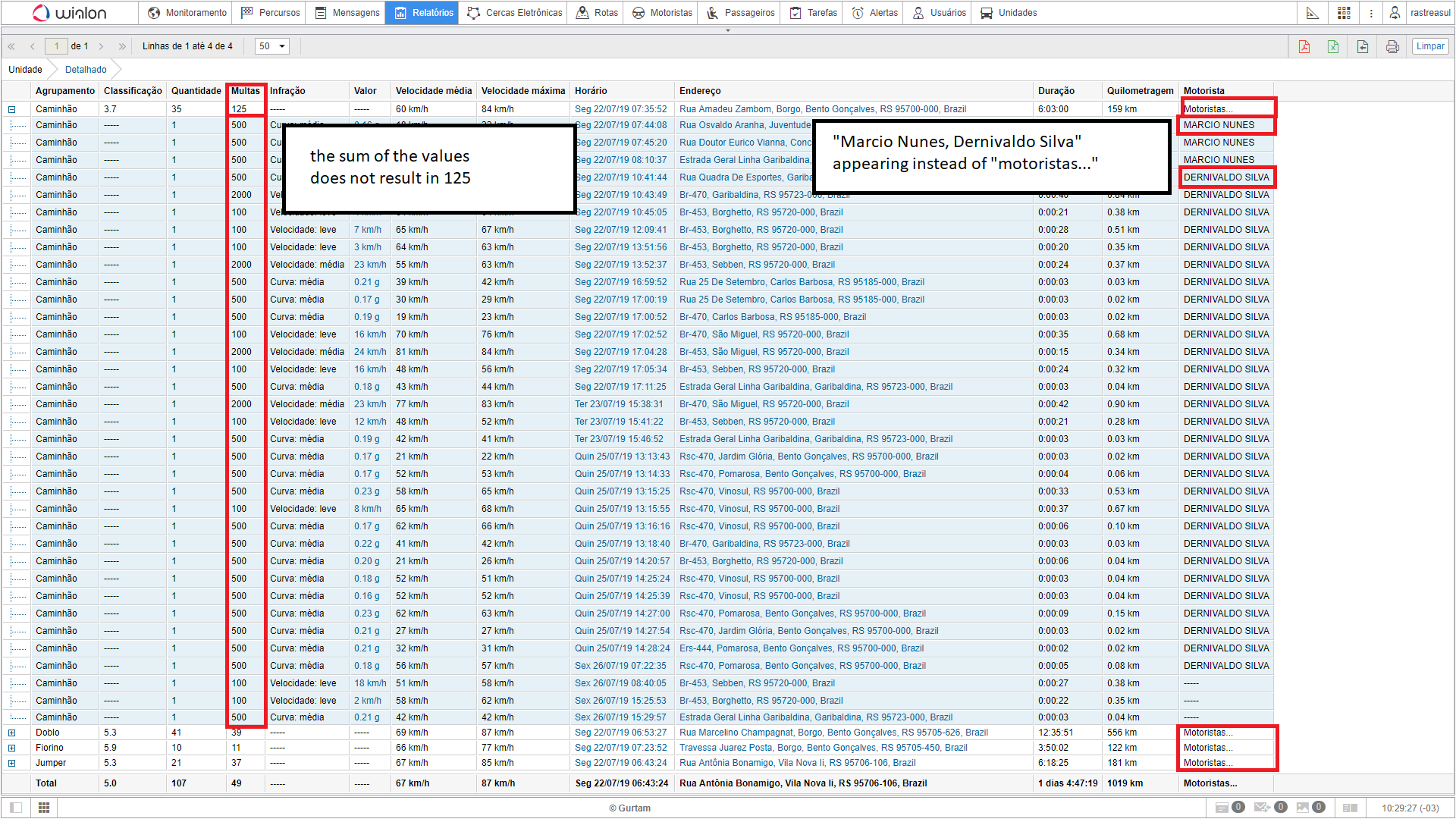

2. I've tried to activate the option but anything changed at all, there is another problem like the drivers in the report Eco Driving, in the attached screenshot. The sum of the penalties doesn't match at the value on the top.

3. Yes, I'm using averaging, but the reports could be showing the result of the division, for example: 100 points/250 km = 0,4 points in this trip.

Yes, I understand, however the values is a little confusing. Look at the screenshots I just did.
