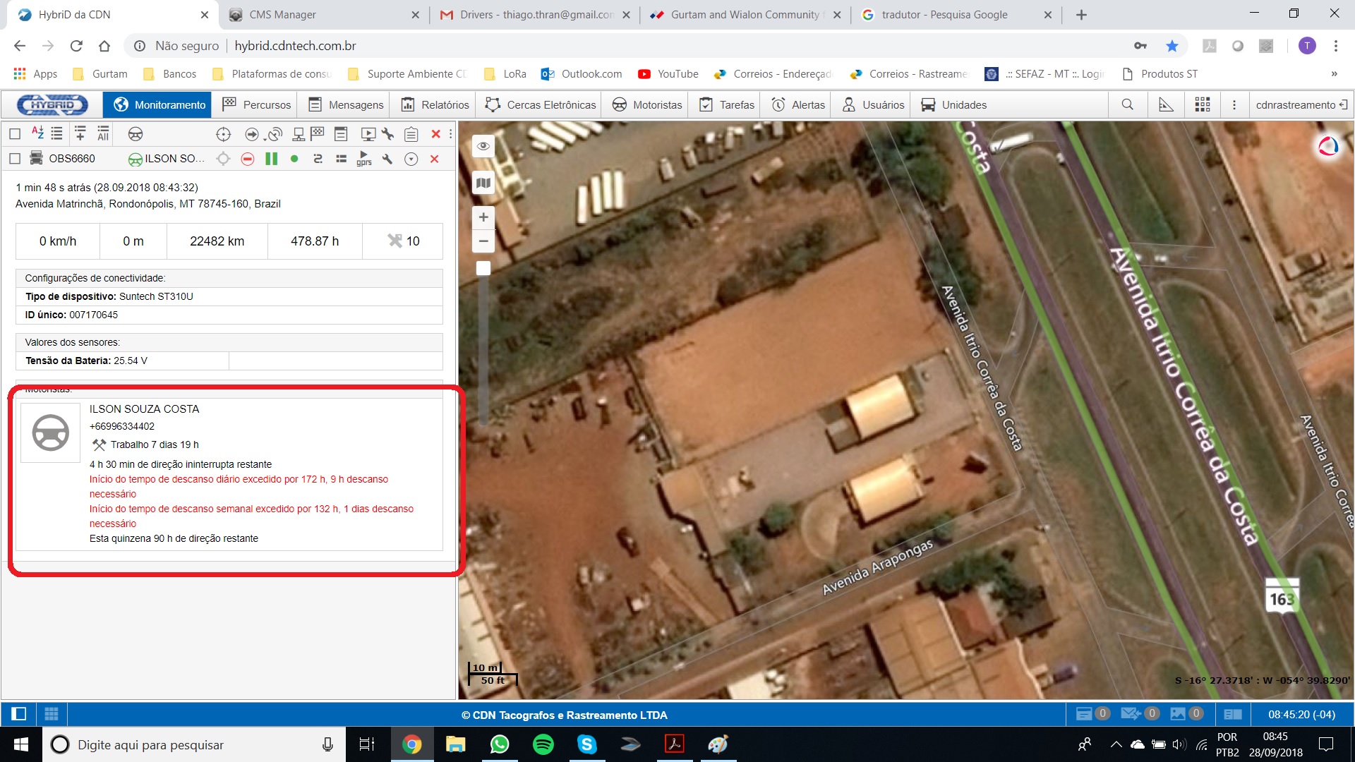

Hello ... Good Morning
I observed the times that are displayed on the drive flap when the driver is binding into unity. I realize that the times that are displayed there are based on AETR rules. but we who are outside Europe should have a tool so we can edit local rules. We are with a project to be executed where our clients needed this monitoring and without it it is practically impossible to make this business.

thiago, can you provide us a link to your local rules? We realize that AETR used in Europe and differ from rules in other countries. To discover the common things and differences we'd like to have more examples.

Hello, how are you ?
Can it be in portuguese ? one problem that can happen is that there is a basic law that companies can use to make collective bargaining agreements with their employees. so it is not standard for all companies since there are different operations, day, night etc etc.
basically the main rules that do not change are:
1. rest time between one journey and another.
2. Uninterrupted driving time.
3. daily working time.
4. daily overtime.
5. weekly rest
