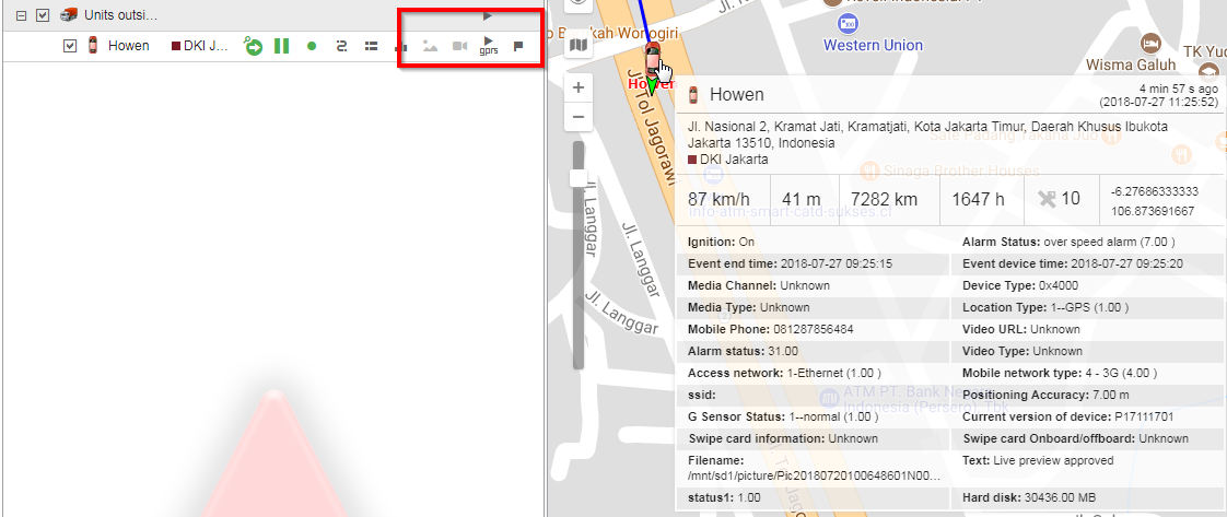

Hello guys,
we use ME41-04 Mobile MDVR on my WL last Version.
but we have struggling about the streaming video and reconfiguration.
like, we already to access in some user, but still can't view the video, the show on monitoring it has no video available (it was full access on it)
  • Video monitoring in Wialon
