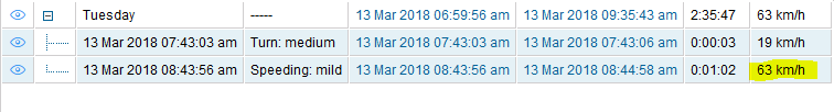

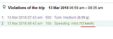

We have just started trailing this for a customer's fleet of trucks, primary need is to capture harsh acceleration.
I have a question regarding the "default" speed calibration/config and how it is reported.
We have run a few reports and viewed/compared with the Eco Driving app. My question after reading docs it says that speeds are drawn from Google maps.
If this is so, why does this speeding not show up when we generate a separate speeding report?
In one instance a speeding violation is shown in both Eco Driving Report and Eco Driving App however it does not show this speeding instance when a Speeding Report is generated.
Thanks.
Please, clarify, where have you found this information.
Please, send more information about this issue to support@gurtam.com:
* user name
* unit name
* report name
* time interval to check
@ Oleg Zharkovsky
Ecodriving Implementation
Re: Ecodriving Implementation
Cheers Oleg,
I think we have found why speeding shows in Eco Driving but not in a standard Speeding report.
We have noted that customer units are setup in Advance settings as "Use fixed limit" speed, rather than by "Use limits from roads".
So with Eco Driving taking speeds from road limits as is noted in doc: https://docs.wialon.com/en/hosting/cms/units/eco a Standard Speeding report will not show this given the different Unit Advanced settings - only showing in the Eco Driving. smile
Thanks.

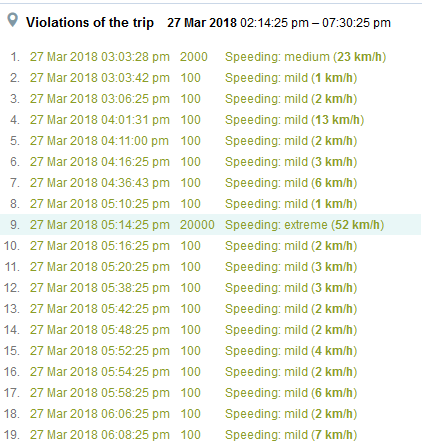

Is there a way that speeding can be filtered in order to disregard, similar to Message validity filtration in Advanced settings of unit?
I see a number of Speeding violations that appear to be way off the charts, suspect that either it may be the unit or another issue. As shown in image attached - one shows the truck driver was doing 54km over speed limit. Maybe we can adjust Eco Driving settings to ignore what would be in this case incorrect?
We have found using limits from roads often very inaccurate sadly - speed changes with roadworks are common and take some time to update.
Cheers.

Good day,
"Messages Validity Filtration" helps to filter out the GPS data from invalid message. If speed from message exceeds value from tab "Advanced Properties", than speed, coordinates, satellites count and altitude are deleted from the message. It means, that it can't be used for speeding or Eco Driving control.
I see a number of Speeding violations that appear to be way off the charts, suspect that either it may be the unit or another issue. Maybe we can adjust Eco Driving settings to ignore what would be in this case incorrect?
Also you can use "max speed" filter in Eco Driving criterias to cut off high speed values.
Roadworks start and finish everyday, it is almost impossible to keep road limits up-to-date in the whole world in real time.
Still you can apply changes in OSM -- our map specialists periodically take new data from this source.
