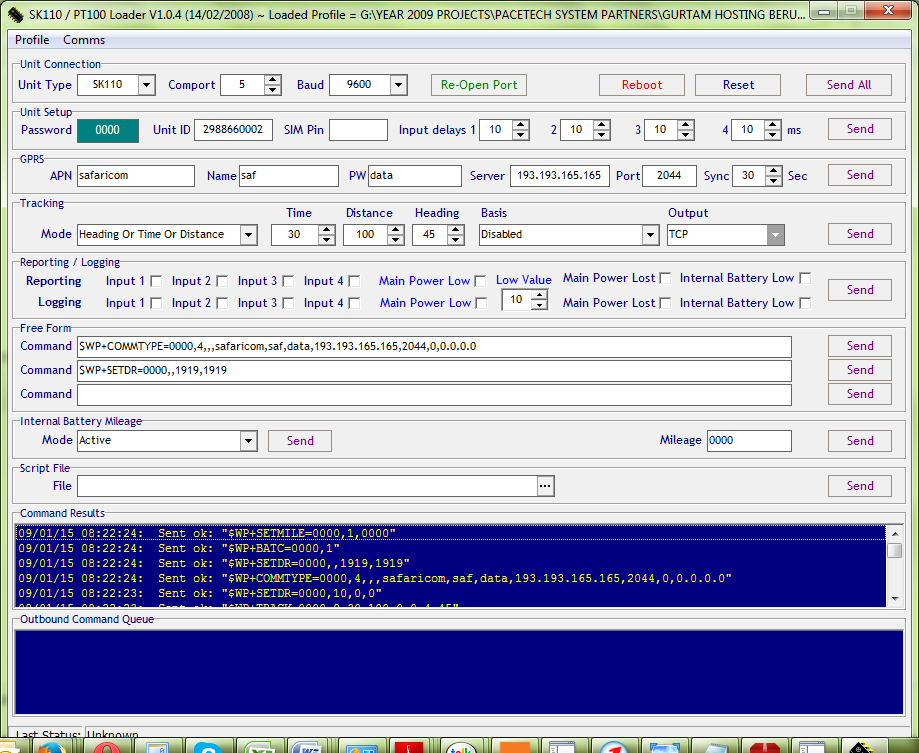

I have managed to get application to configure the Device and did set all settings fine and sent to the device,
But i still cannot get the Device to work on platform anyone has experience on this as i can see there over 100 Same devices being used on Wialon Hosting .
See Attached
Regards
Steve

hello good day
I have the same situation,
I have not been able to configure these gps, I appreciate your help with the ideal software
Best regards

Please, see the attached manual
https://drive.google.com/file/d/12ZI_ja … sp=sharing
All the commands are sent through the program "Terminal" or "HyperTerminal"

Thanks, you know the speed that I should use for this configuration, I have tried several times but, there is no answer from the gps

As I remember the speed should be 57600
https://www.screencast.com/t/QLLmVzPT
https://www.screencast.com/t/Qsi7EVIRk
