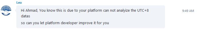

Hi Yavi,
We are in close communication with the manufacturer. They believe that this issue must be handled at the server side.
Cheers!
Ahmad
