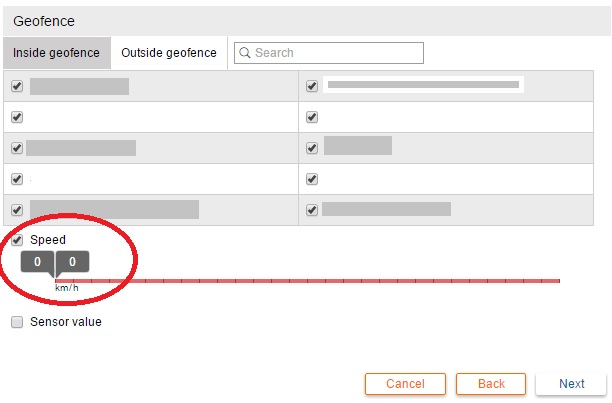

I use only one vehicle for this notification. Simply I explain, when vehicle enter in geofence ignition ON/OFF doesnt matter but speed should be zero and notification generate for this event. I used speed parameter in notification setting but it is generating in any speed. please check image.
In this notification all sensor name and their value added. So client want fuel sensor value with stationary condition (with zero speed) no matter ignition ON/OFF. please solve this problem.

sales.gps.zoom  from what  i can see you did vice versa, the 'triggered' area for the speed is marked with red color, so make the allowed area from 1- ... km/h to get what you need.

Dear poal,
we had set 1 to 5 km speed limit but notification not triggered with this value.
Client want fuel level at their all sites. Obviously, Fuel level can get accurate in 0 speed. In this notification we set All sensor and their values. But when vehicle enter in geofence with speed fuel level getting wrong value. so we need to set this notification in zero speed.  in stop condition.

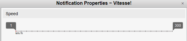

Re: Geofence Entry/Exit with Sensor value
sales.gps.zoom
have you tried something like this?
