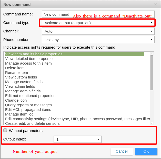

The maim idea is the same for both of your solutions: by command from Wialon you should commutate the state of some Teltonika output.
We created special commands: activate and deactivate output.
Please see attach.
