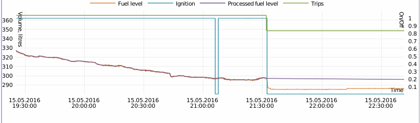

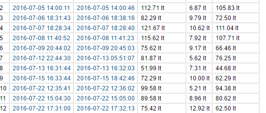

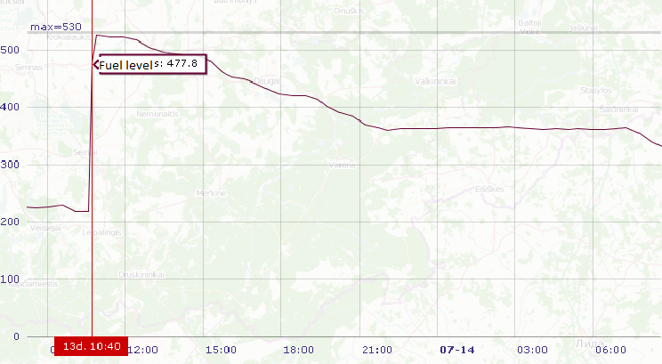

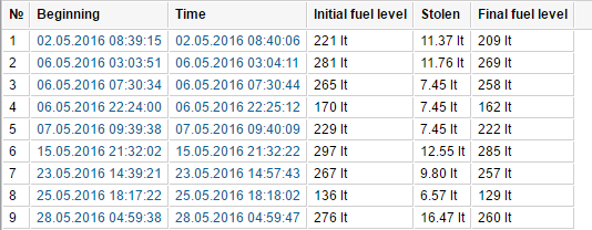

Truck DT-5j-xxxx has had around 9 theft in last month as shown in table. If we examine the fuel theft o 12.5 liters on the 15th-05-2016 item number 6 on the table we can get the following graphs.

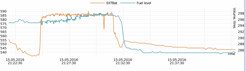

On the 1st graph( Fuel level vs ignition and trips) it can be seen that when ignition goes off at 21:32 the fuel sensor data falls. This seems to be common in all the thefts.  Further more if you look at the second graph (Fuel Level VS Ext Battery Voltage ) you can see that the 24 v batter voltage fluctuates around 2 volts at same time as the ignition off time. 21:32 ...
I am very confused and not sure if the battery is causing this problem or not. Maybe the fluctuation in the battery is causing the data to change but if thats the case the data should return to normal immediately once the fluctuation has stopped.

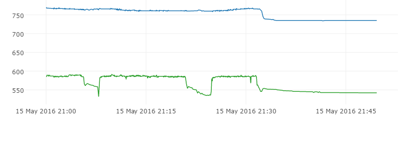

last one is raw data of Ext Bat and Fuel Level.  blue line is Fuel level and the green is the ext bat..

for me it looks like a technical problem in the fuel level sensor... it should not drop that much and than suddenly jump up again.
did you ask the manufactor of the fuel level sensor about this?
also strange for me that you have the same behaviour in all of your trucks.

Analog sensor are affected from several things including, on board voltage, cable routing,  missmatch with the locator, the first thing is obviously ask to MFG, it can be fixed may be trough configuration software, also add an in line voltage regulator or some kind of filter ONLY to know that there is no issues by the feeding voltage, i can help if you give more details.

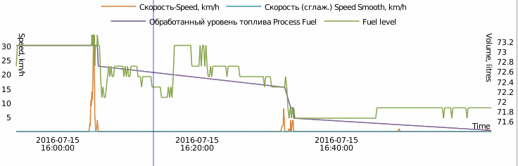

Dear All,
Thanks for your support.
Yes you are right it was a problem with the way we plugged the device. We had not used the same source for Power for both the gps device and the fuel sensor.

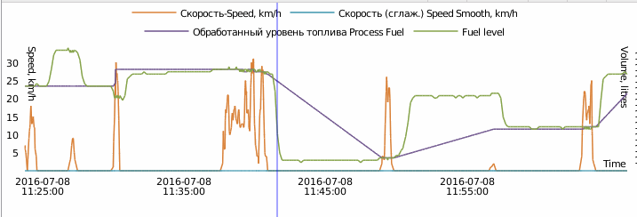

However now we have another problem which is very frustrating. We are using Chinese FLS from a very big company which we have visited.
The problem is that we are getting fake thefts and fillings just when the vehical stops for a few seconds( 30seconds or so) in traffic. Most of the fuel thefts and fillings are around 7 to 10 liters and take place within just 30 to 40 sec. This seems to be not possible as when you see the graphs you can see the Vehical engine was on and had just stopped for 30 sec or so. What kind of setting can we apply to avoid this.
The problem is the the sensor by default filters the data for over 120 sec by default.
I am very confused on how to solve this problem .. please can someone help

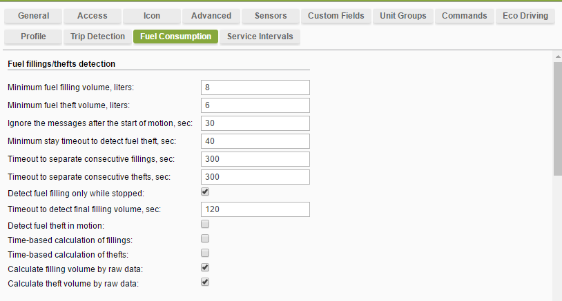

We have installed analog sensor and its working good but client vehicle fill fuel once a day but in track history it shows many time fuel filling marks and theft marks too. what is the setting we should change for this ?Please help.
i set "filter fuel level values" so its changed but on which thing based on this value should be set ? Please help to solve the issue.

It might be issue with fuel consumption setting. Try to make filteration level between 8 to 12 and also avoid time based filling and theft if it is truck.
