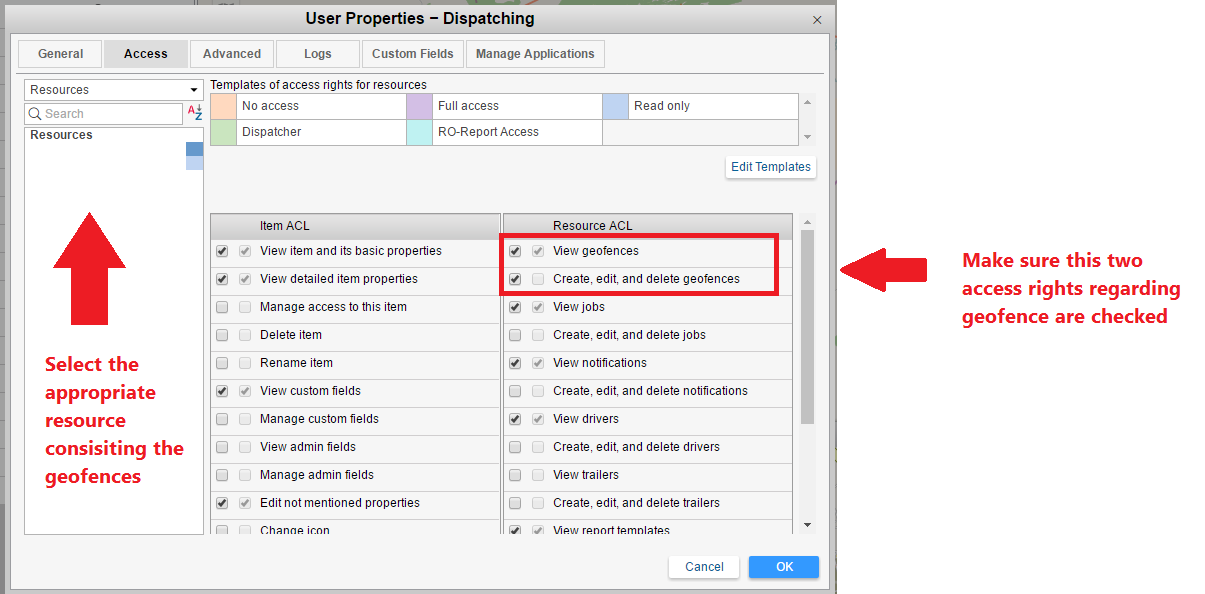

Hi, Looking in to your attached screen shot, it seems like you have selected vehicles rather than Geofences when you create your Geofence report template.  please see the attached to better understand what I am referring to.
In addition when you create your user please make sure you have assigned your user with the privilege to create, read and update Geofence resource. (please check the second attachment ) or the user has the privilege to have access to the resource consisting the Geofences.
If all are ok i think it is better to check the API request you are making.
