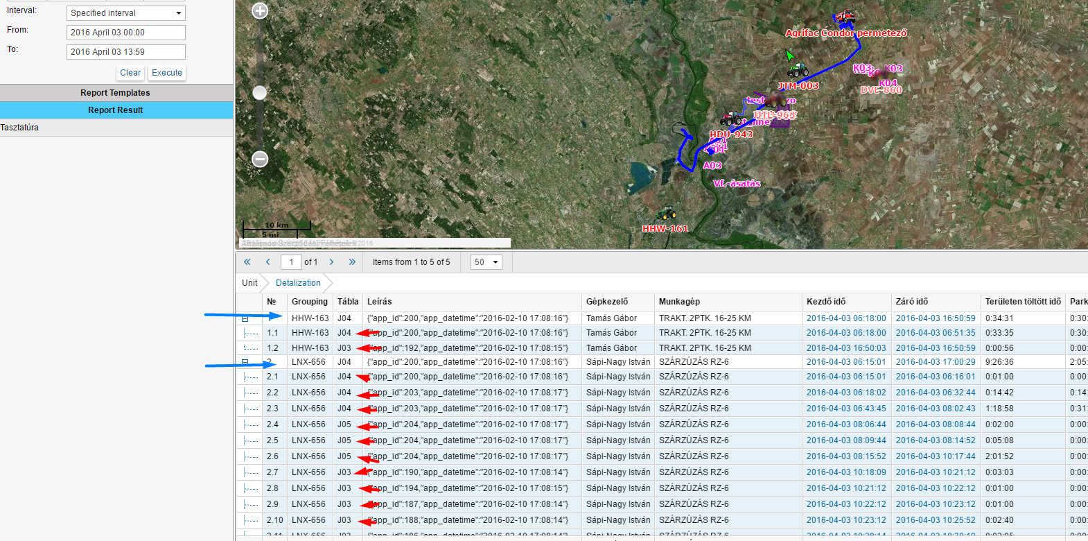

We would like to get every nested rows from an executed report in a single API call. As you can see at the attached picture.
I need to import every "subrows" in one request.
1 . report/cleanup_result
2. report/exec_report
3. report_select_result_rows ({"tableIndex":0,"config":{"type":"range","data":{"from":0,"to":<row.count from exec report result>,"level":0}}})
4. And here I want to get all "subrows" for the "main" rows from above response. There are many "main" rows, not just one. (At my picture are 2 blue lines)
Also downloading each "subrows" in different requests is very slow..
With an ajax call we can get "subrows" in different requests (when I click on plus):
report/select_result_rows - params:{"tableIndex":0,"config":{"type":"row","data":{"rows":["2"],"level":0}}}
I need the same result/response as the above request produces, but for many "main" rows, not just for one from SDK.
Any idea how can we manage this?
Thx,
Attila

Hello
You can use this params for report/select_result_rows request to get rows range with nested subrows
params: {
    'tableIndex': 0,
    'config': {
        'type': 'range',
        'data': {
            'from': 0,
            'to': 0xFFFF,
            'level': 1
getting every nested rows from an executed report in a single API call
Re: getting every nested rows from an executed report in a single API call
Many thanks, it worked well!
