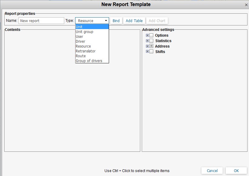

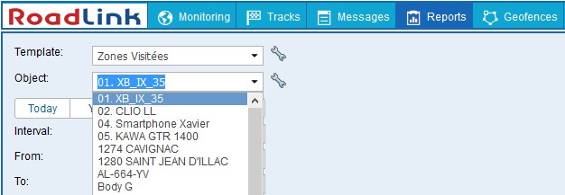

Few of our customers asked us about the geofence report to make some change.
Today, when we create a geofence report we need to flag all the geofences in the report table if we want to see the geofences in the report of vehicle or group of vehicle. And the report is create about vehicle, not about geofence.
When many geofences are created with many vehicles, it's almost impossible for a customer to come back to the report template to flag new geofences created. And it's very difficult to determinate which vehicle was in a specific geofence.
The reflexion is to replace the choice of the object by the geofence choice in the report table.
I guess that it ask the creation of "Geofence" choice in the resource of the report creation ?
