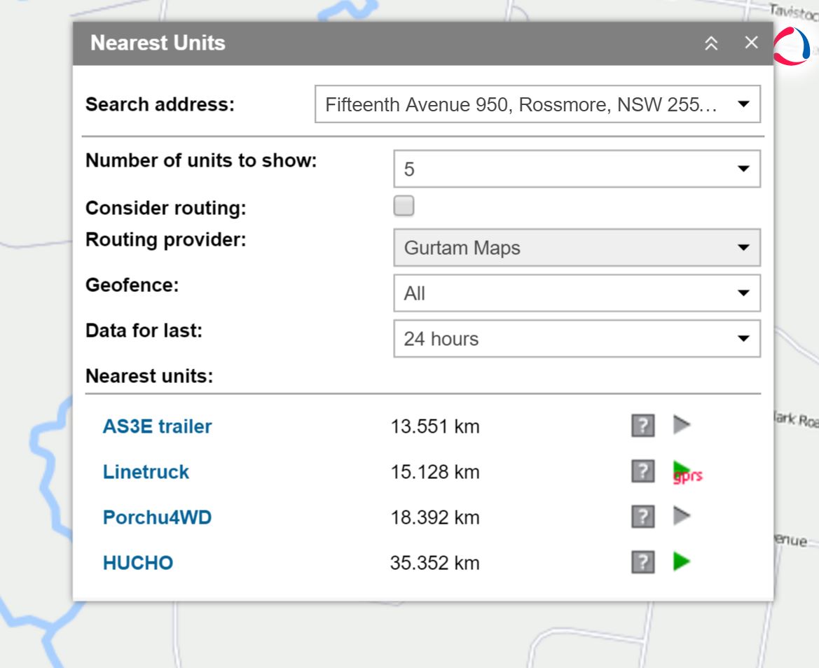

Yes yuo can do this easily just use your ( set square tab)  apply address & and time period - units near the location .
perfect for what you need

Thank you eyeinthesky,
Yes it shows the nearest unit to the location but it doesn't show that they have actually visited the street or if they did when unfortunately, unless I missed something. smile
Timeline available is increments up to 24hr or all time, client will wish to know if one of there service vehicles has been to location for example for the last week. If no site visit they will know to take appropriate action to send someone to site.
