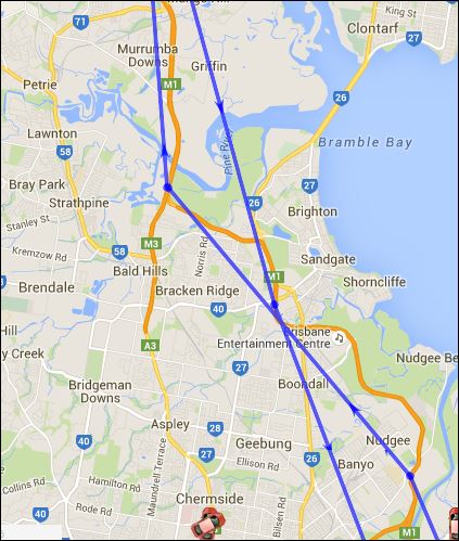

Currently we have a number of LMU 3030 scripted and in utility vehicles (Mitsubishi Tritons) and they are not working correctly, We believe that they are not picking up or recognising when vehicle engine is on and therefore stay in sleep mode while logging every 10 minutes. Showing no tracking or movement just straight lines between each logging.

FleetPursuit  Please send us your current configuration file to hw@gurtam.com
We'll try to help you.

hi !
You can send to the unit the SMS !VV   in order to know if Mitsubishi is or not compatible with some protocolo in the OBD-2 Standard, This SMS will return the Vehicle Detection status, VIN, supported VBus Parameters and Indicators, and the current count of DTC's detected

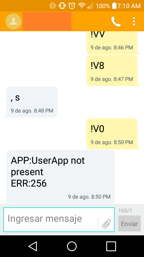

Hi, i have LMU4200 with jPro, but this present error for jPro "APP:UserApp not present ERR:256", someone knows why?
  • ➤ CalAmp
22
➤ CalAmp
Re: ➤ CalAmp
you need to configure the streams as D board for the pod,  si the Jpod or Vpod?
