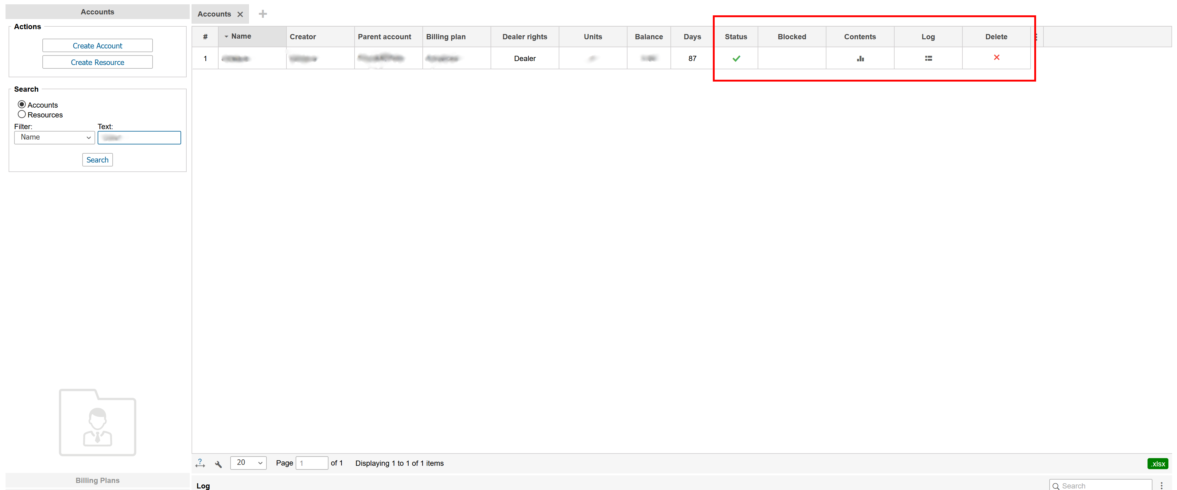

Please take a look at the screenshot I have taken from Accounts list. You see that there are some buttons in the list that help you to control or query some information from account without opening its properties. Let's talk about the Status button. You can easily click on that and change the status of account (block/unblock it). What I have proposed is same feature for below user's properties:
- Can create items
- Can change password
- Can send SMS
- Enabled
- Can change settings
This way you can easily click on a button and change any of those setting for a user. In some systems they call it "In List Edit".

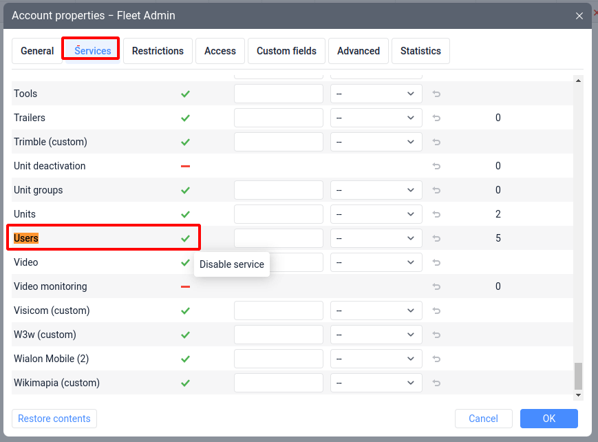

I've been notified that a recent update has has some unexpected implications. More specifically,  when creating a user and unchecking the "Can edit settings" tickbox, the user should not be able to view any additional menu tabs. Considering this, our users should not be able to see the "User" menutab, but they can. Attaching screenshot for your reference. Please advise.
Given that this is the first time that I'm using the forum I may be misguided in stating my question here. Please excuse me!
Thank you
New features in CMS for Users Tab
Re: New features in CMS for Users Tab
v.sioros the Users tab can only be hidden if the relevant Service in an Account properties is disabled:
