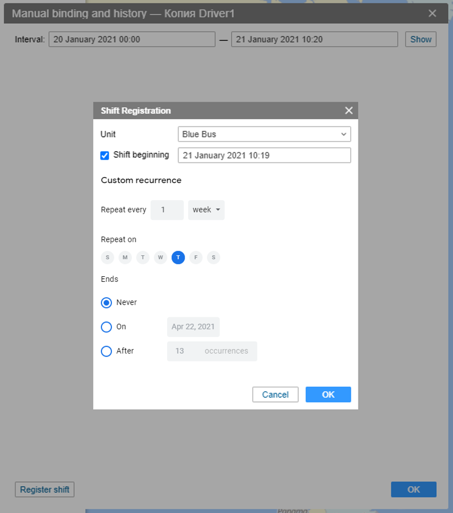

At first sight your suggestion does not look complex, but the more I think it through the more I find it pretty difficult to implement. Let me explain.
At first I thought about something like on the picture1 - see it attached. To improve the shifts settings, to make the shifts creation more agile and make it possible to create them in the future. Is that something you wanted to see in the system, isn't it?
But after that I started to think about several drivers on one unit and their shifts. In the example you have shared with 3 drivers it would be a pretty complicated and boring piece of job to create for each one of them the same shifts but in different time periods... And then any changes in the shifts (e.g. a few minutes forward or backward) will affect other drivers on that unit and you should solve it manually... Thus, it would be more logically to put the shifts' management to the unit, right? So that unit's utilization by shifts could be managed in the unit's settings...
OR you could create unit's shifts in the unit settings and then go to the Drivers tab and link drivers to the created shifts. But that would not be very easy to use as well, since the feature is divided into several tabs of the system.
With all those thoughts the scope of the feature seems to be a lot more than it was in the beginning.
I do understand the problem you face, but at the moment I cannot see the perfect solution to solve it. It would be great to hear your thoughts on that. Which solution is better for you and why, what would suit you best.
