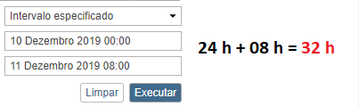

Report Period Inside Calculator
(edited by Fernando Brochetto 23/06/2020 15:25:59)
Re: Report Period Inside Calculator
It's working mana thanks!!!!
New design of calculator is perfect!!!
