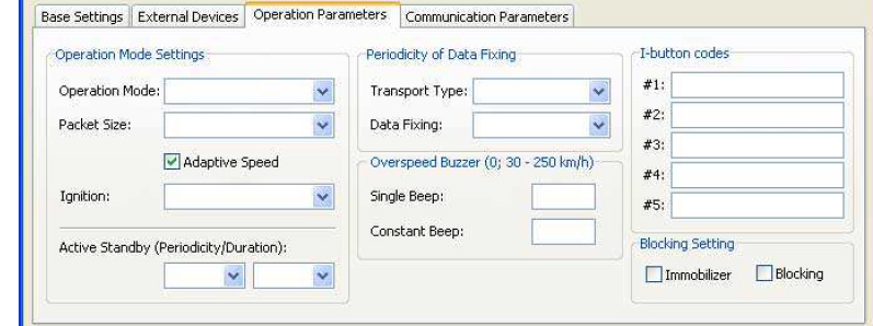

I'd like to set up a device to send a digital output to a buzzer over a certain speed limi
Over speed buzzer =
GuardMagiv VB6; Guardmagic VB7 ; Guardmagic VB8 = setting speed limit in modules.
Two steps speed limit.
Modules have a special output to buzzer .
(buzzer included in modules set)
