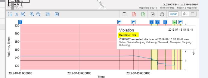

The second one is the 'N/A for Duration' found in chart. It happens for some violations/events such as Overspeed and Idling. Please refer to the attached file for screenshot. It shows a violation in term of 'Idling', but there is no value available for 'Duration'. We can get the duration of Idling from, say Engine Hour table, but why not in charts? It looks weird if the values can be found in one place but not another next to it. Please allow the charts to collect values of 'Duration' like tables do.

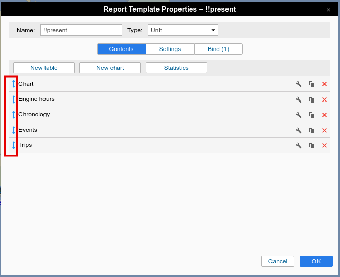

cs.lee, to change the order of tables and charts use arrows in front on names (see on the screenshot).
As I see, you write about a tooltip to a marker with type "Event". The event may be registered by notifications or by hands. Any event has the following elements: description, date, location. When the event is registered by notification, it has no duration as it is registered as soon as detected before the event is finished. Notifications are a tool for fast reaction on any happening. That is why we cannot show duration there.
But thank you for your attentiveness. You helped me to find a bug. Instead of N/A duration in tooltips Location field should be. We will correct it soon.

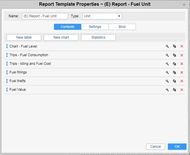

In the same report template, I have tables and chart. I drag the chart up till the first of the list, but the report result shows the chart at the bottom. I have contacted the support team regarding this and been told that charts are always at the bottom, hence the suggestion to make it possible for users to adjust chart position in a report.
