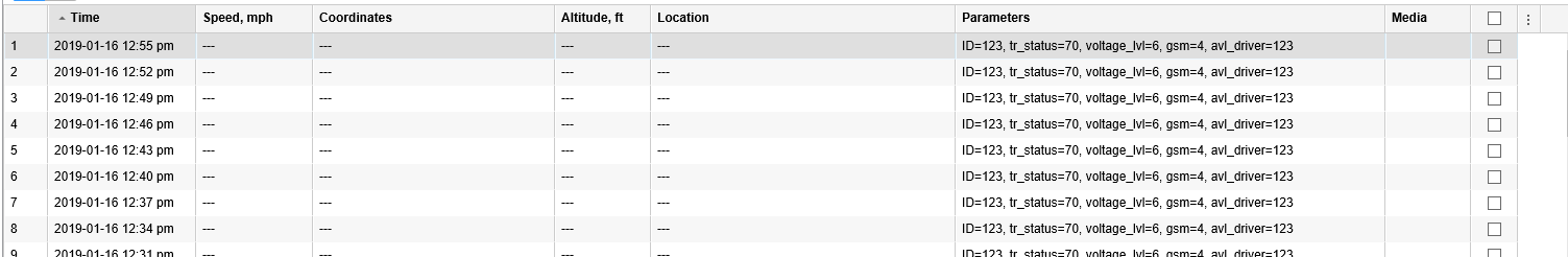

Hi,
I was able to sync the unit with wialon after the firmware upgrade . Requested videos no problem .
Now I don't see is sending coordinates please see attached
thank you

Got it working on Wialon Hosting ,
Picture upload and Video upload works fine.
