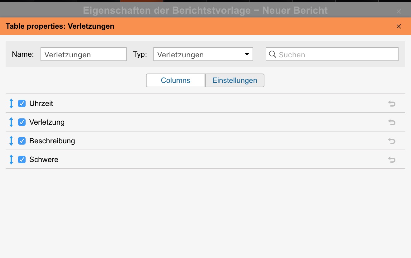

Hi shmi,
he he he, nice idea but in the "driver group" report there is NO FIELD with drivername/driverid, so i get a report which i can not connect with a driver...
(no drivername in report... weather you guys forgot it or i am just too stupied to find the right configuration)
Wolf.

Re: TachoView for multiple Drivers / Monthly Report
Visit second tab from your screenshot and add grouping column "Driver name"

Aleksey, you are as always the best.
My problem is solved. I can use API to enhance the report and create whatever the customer wants.
(and well, adding a sort algorithm to get another field is tricky :-)) Lesson learned for next time.
