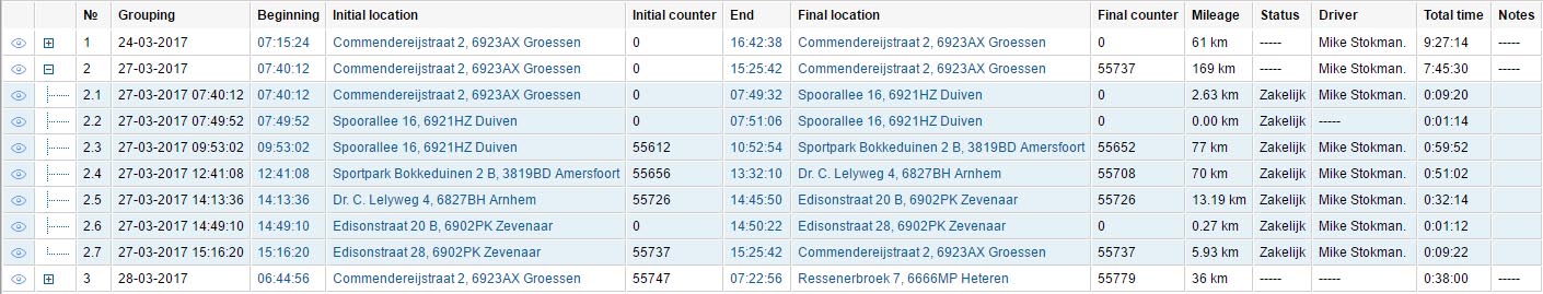

Im sorry it was indeed report Digital Sensors that misses the field Status.
As for now the report Engine Hours still does not give correct odometer values. (see attachment)
As for the report Digital Sensors odometer values is working great but this report is missing the field STATUS (see attachment)
It does not matter for us if you fix report Engine hour or report Digital sensors, most important is that all the needed fields are correct in the report.

Re: Report
Dennis , seems, you've attached one screenshot twice... So it's still not clear what's the differ..

(edited by Dennis 28/03/2017 16:00:49)
Re: Report
Hi tata
i adjusted the screenshots, now they are correct.

Hi, Dennis
i'm following both conversations here and with support team and must admit that both tables are equal for your purpose.
Actually we accepted to add initial and final mileage to the Engine hours tab - so you will enjoy the same as with Digital sensors + Status.
Cannot promise it's gonna be done pretty fast, but if you confirm that this is what you were looking for we will include it in our timeline.
