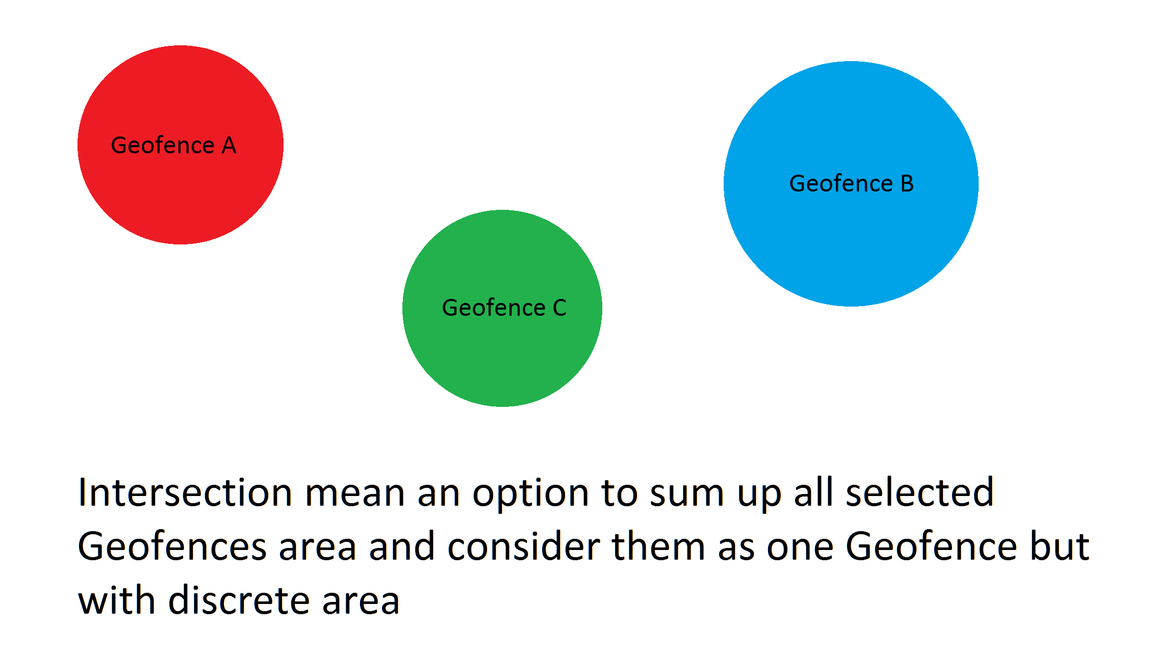

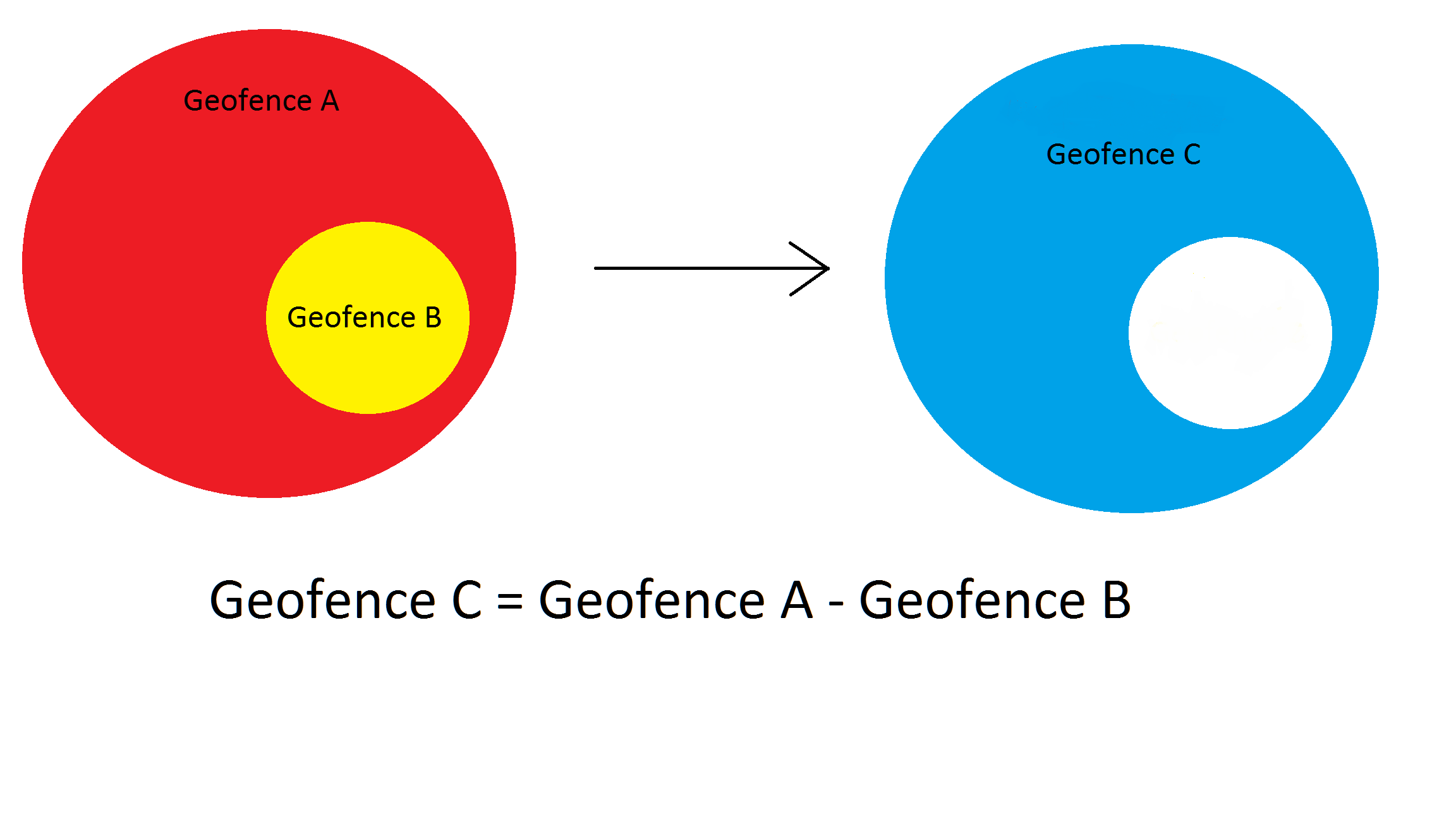

2. In Geofences or other objects of Wialon what are related to Geofences (like Reports) it would be interesting if we have an option to intersection 2 or more Geofences or subtract them. Please check attached charts for better understanding of what i have in my mind.
Could you tell us more about this idea? So far, I'm not really getting the main point and essence of such development. Please describe in detail your proposal and how you plan to use it.
