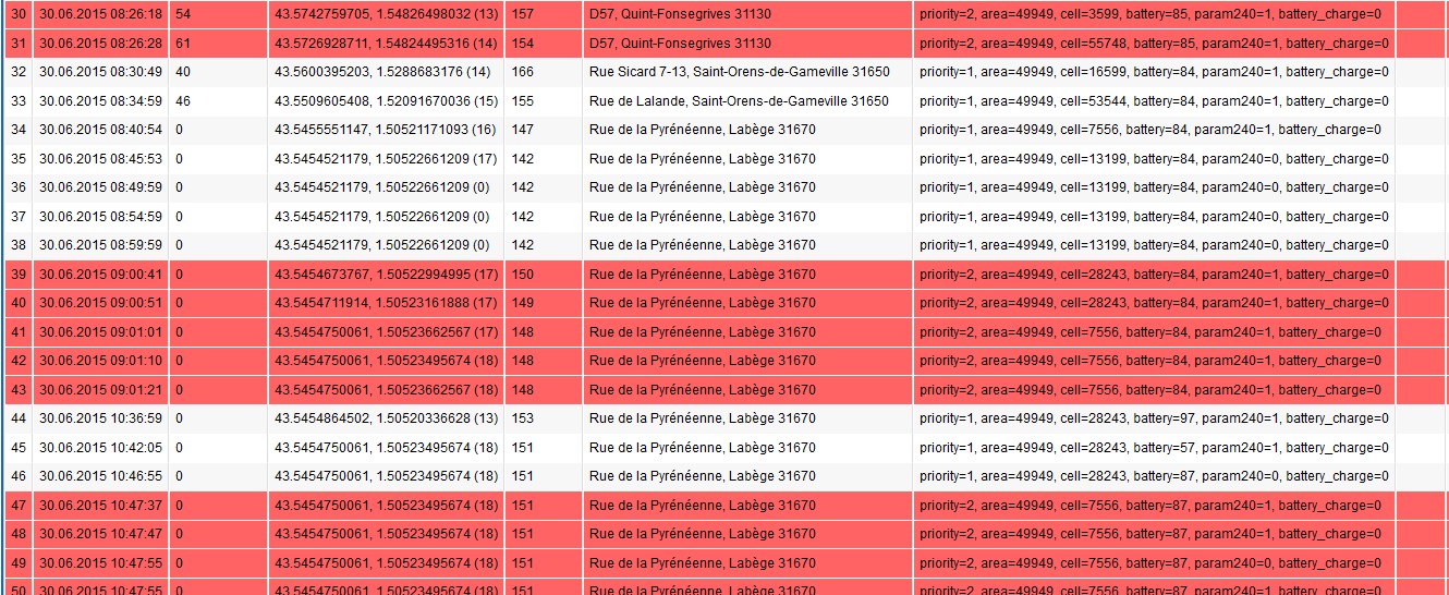

- First : The device send "Param240" which is not indicated in the user guide neither in the device page in the Gurtam website.
This parameter sometimes turn "Param240=0" and other times turns  "Param240=1" (see the attached pic).
Is anyone of you could indicate how I am supposed to translate this Param240 please ?

I guess that we do have to create a calcul table in the sensor page, I try but I don't know where I have to indicate "Low", "High" etc...
I just need to localize the 4 params in Wialon Hosting monitoring because as you can see in the pic attached, sometimes the priority is 1 and others times is 2.

Paramater 240 is your movement sensor  so yes it will change form 0 to 1
Item 2 ...that should be set through the configurator to indicate the level of the IO send, this also controls whne the unit sends when an IO trigger is received.
Item 3 ..you can set up one for the buttons so that it is captured when pressed in Wialon. You would turn the normal periodic sending to a high value as I do not think you can turn it off completly. Alternative is to set up a geofence trigger on the device to alert on entry and exit.
