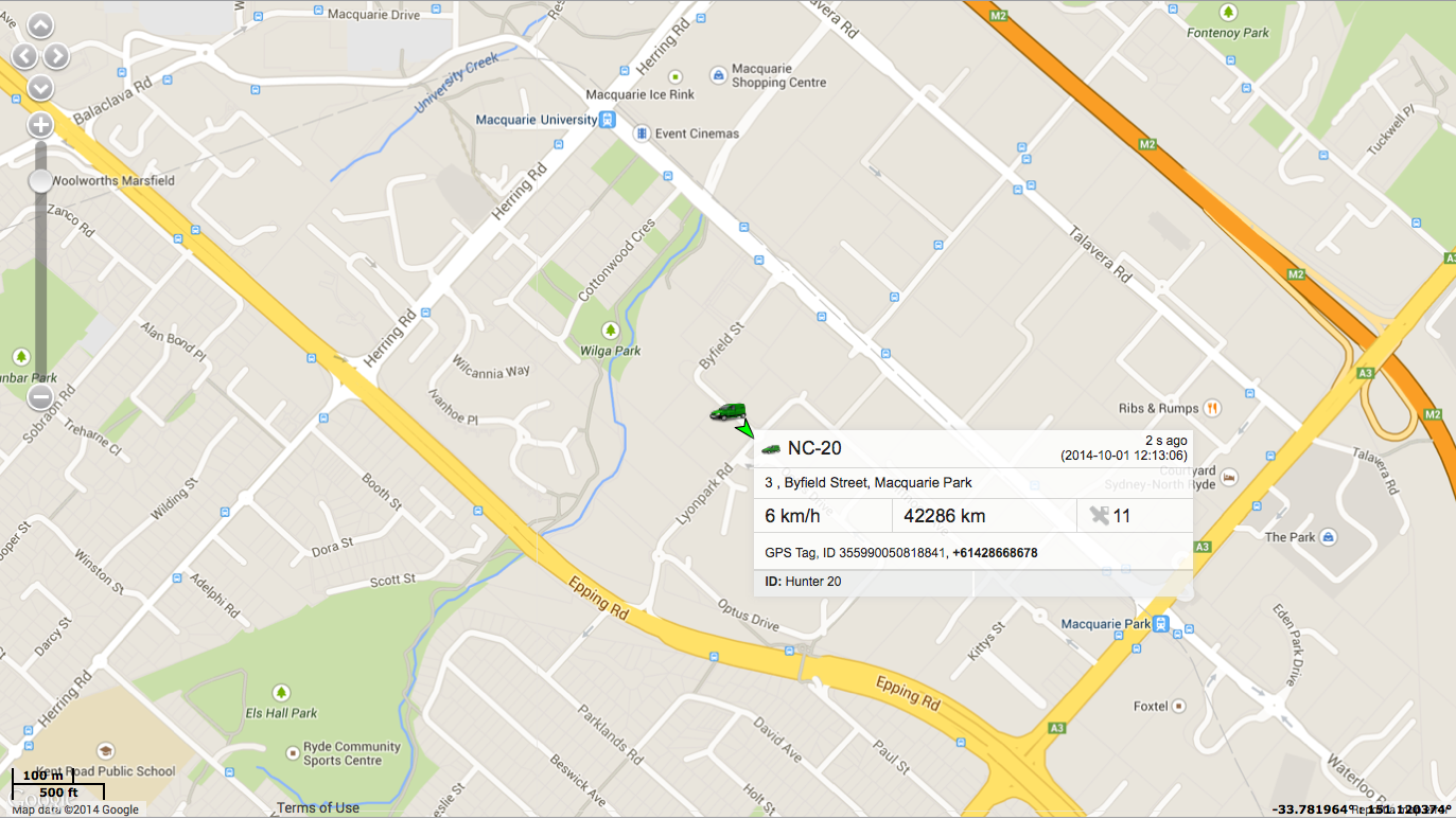

2. There is no public available API that allows us to get this kind of information about the GPS satellites. We can track only vertical and horizontal accuracy. And assume satellites count base on this parameters.
The attached image shows the tracking online with the Android version of GPS Tag.... You will note that it does show the satellite count. This is an import feature, so please reconsider your response.
Android OS allows programmers to get satellites counter programmatically, but iOS SDK doesn't.
