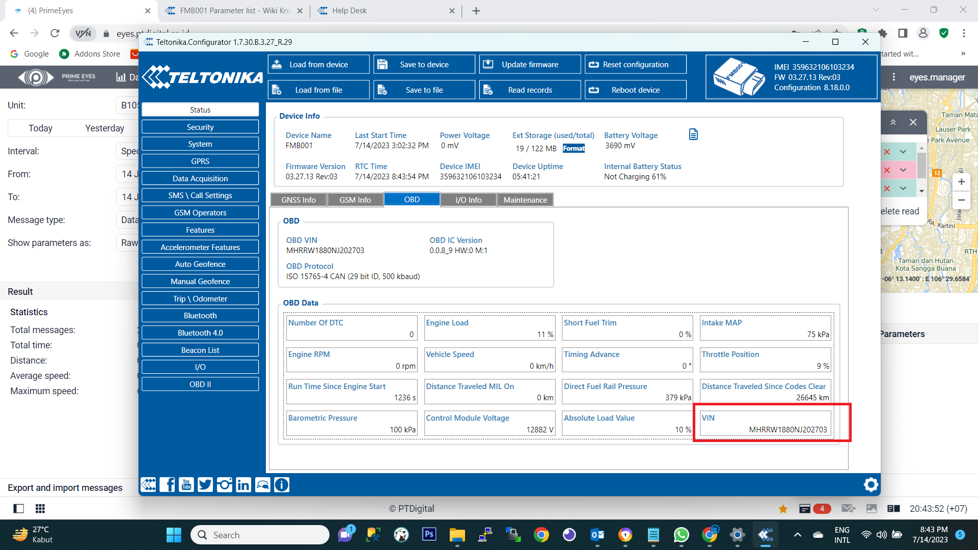

I use FMB001, I saw VIN info was supported by the vehicle, how to show it to Wialon's Report or Monitoring Dashboard?
I didn't find such message in Messages -> Raw Data
Thank you

dev the value should be transmitted in the io_256 parameter:
256    VIN    17    ASCII    0    0xff    -    -    VIN number
Might be something should be adjusted in the tracker config.

Greetings dear partner,
Please send us a configuration file of that device to support@gurtam.com. We'll analyze the settings and give you tips to get the needed data.
