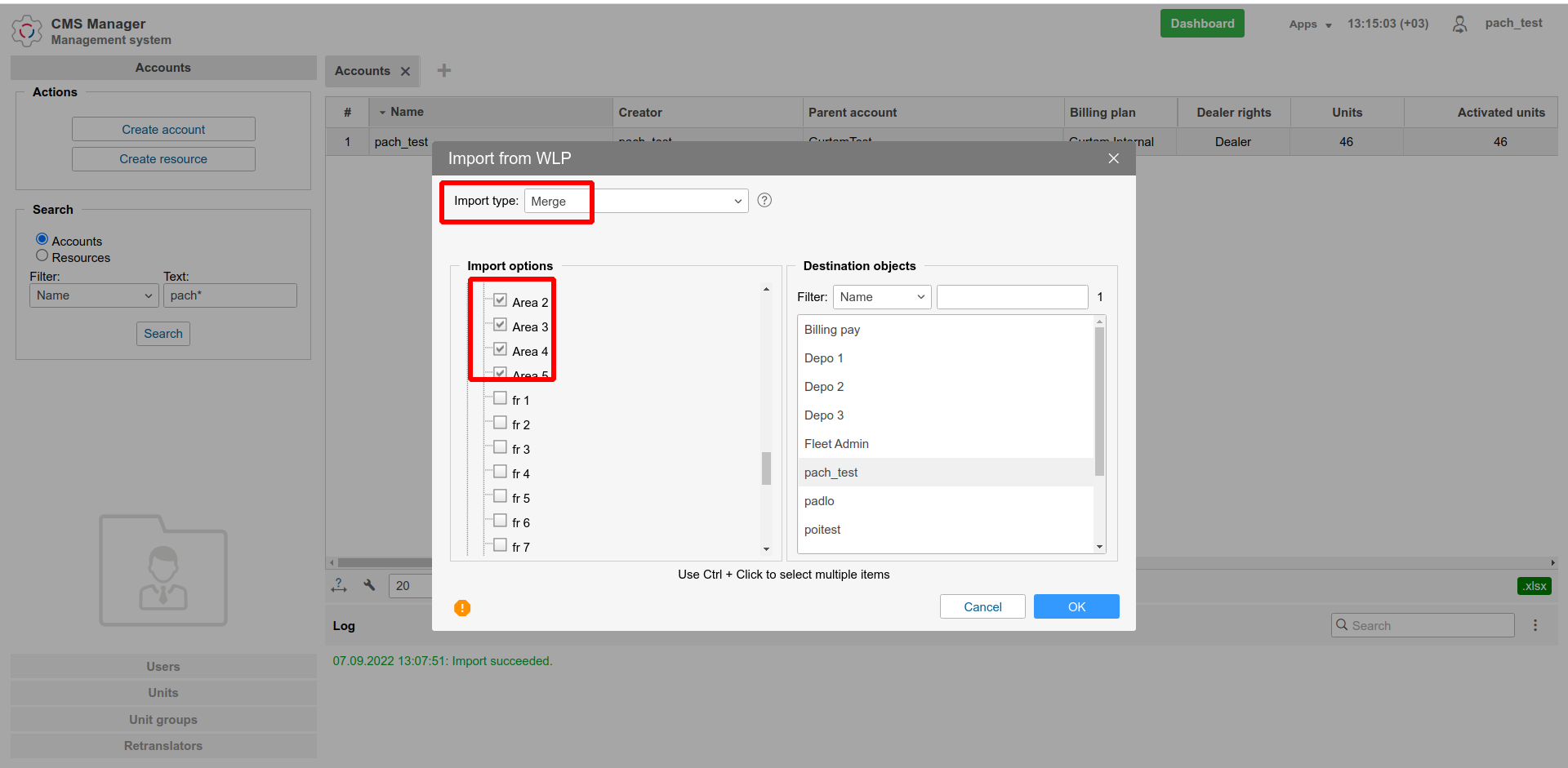

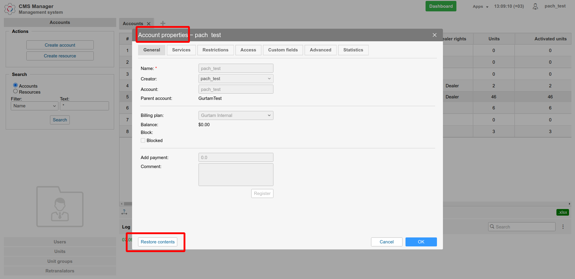

You can restore the previous settings via the option «Restore content». Open an accounts properties, that you want to restore icons for. In the General tab find the button to restore the content. Open the menu, select a date and switch the restoration option from Replace to Merge, then select the required geofences and click Ok. After that, the system should revert the changes and restore the icons and other settings of the geofences as per the date you selected.
