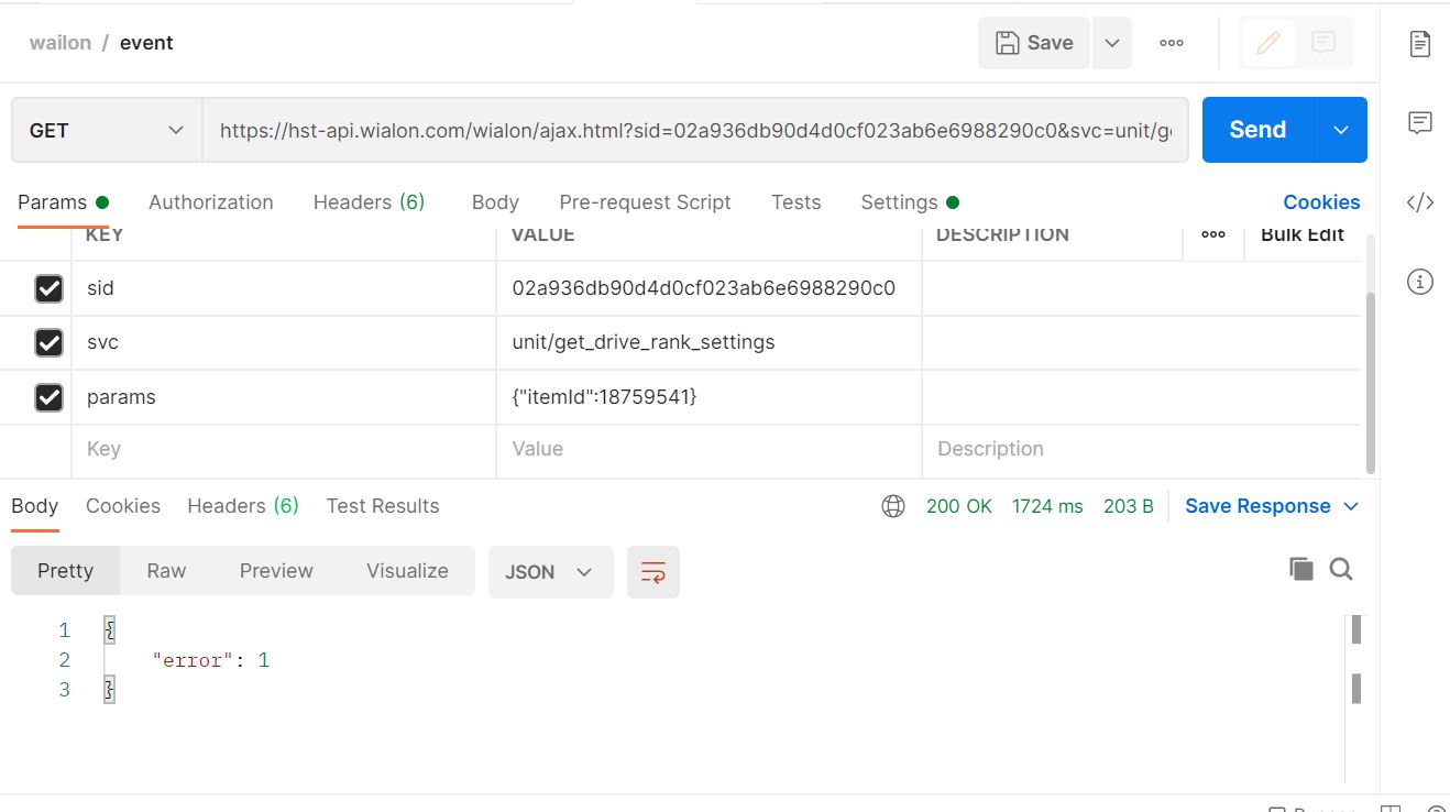

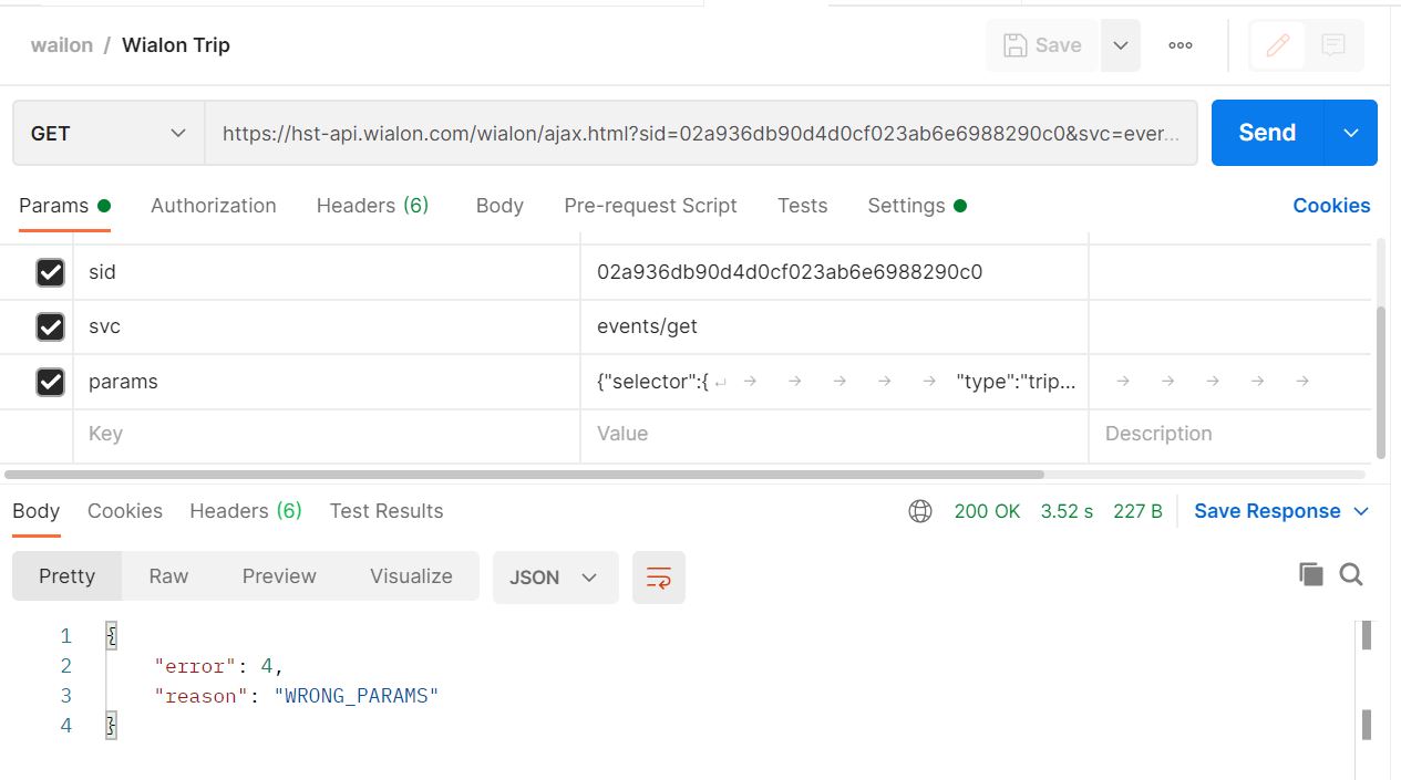

Hello Dina,
Thank you for your response.
We are getting error while trying to fetch the Event and Trip data(attached screenshot)
Below is the API call what we are using
Event
https://hst-api.wialon.com/wialon/ajax.html?sid=02a936db90d4d0cf023ab6e6988290c0&svc=unit/get_drive_rank_settings&params={"itemId":18759541}
Trip
https://hst-api.wialon.com/wialon/ajax.html?sid=02a936db90d4d0cf023ab6e6988290c0&svc=events/get&params={"selector":{
"type":"trips","timeFrom":"20210128","timeTo":"20210128" }
Please let us know if these api call are correct or any changes are required

Hello!
Jayateerth.Sullad , for the fisrt request unit/get_drive_rank_settings  error1 means not valid session.
So please make sure that you apply the id of current session (which you get after login).
Also please note after login (or after last request to server) the session duration will be interrupted after 5 minutes, if there are no one requests send to server.  To hold session it needs to sends request every 5 min, or it can be executed avl_evts (without any parameters) , for example, every 2-5 sec.
Regarding events/get request.
Before you get events, you need to load it. You can use the combination of load + get
For example, get trips for certain peridof.
svc = events/load
params = {"ivalType":1,"itemId":21728414,"timeFrom":1618779600,"timeTo":1619557199,"detectors":[{"type":"trips","filter1":0}],"selector":{"type":"trips","timeFrom":1618779600,"timeTo":1619557199,"detalization":3}}
sid = 0239e78693b85d6f2e25e7c10328776e
Response returns trips in "selector".trips
