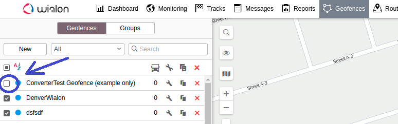

Hi,
We’re trying to figure out how to CHECK mark the visibility box to show a specific Geofence on the map by API. We have not found the flag for this. Can you provide an example of how we can achieve this by API?
Thank you

Hello!
From login response you can check parameter "znsvlist"  where
"m" - panel mode (0 - group, 1 - geofences)
"e" - viewed (checked) geofences  where value like resurseId_geozoneId
"go" - opened geozones group in group panel mode.
So you can get geofneces (resourceId_geozoneId) from e parameter.
