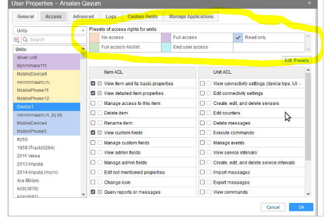

Hi there,
We would like to API call “Presets of Access Rights for Units” that are already configured in Wialon CMS for the dealer admin account “gps_platform_admin”.
For example how do we look up the following presets No Access, Full Access, Read Only, Full Access-NotSet, and End user access. Please see attached circled information below in yellow. We would like to Read and Edit preset label names, and permissions for this presets from our web application.
Thanks

Hello. User can have "access_templates" custom property (update with item/update_custom_property), that contains a JSON with those presets:
+ access_templates example
    "avl_unit": [
            "id": 0,
            "name": "No access",
            "color": "rgb(255, 217, 191)",
            "acl": 0
            "id": 1,
            "name": "Full access",
            "color": "rgb(211, 191, 229)",
            "acl": -1
            "id": 2,
            "name": "Read only",
            "color": "rgb(191, 212, 242)",
            "acl": 16931
            "acl": 880333094897,
            "name": "Preset 4",
            "color": "rgb(202, 229, 191)",
            "id": 3
            "acl": 5,
            "name": "Preset 5",
            "color": "rgb(191, 242, 242)",
            "id": 4
    "avl_unit_group": [],
    "avl_resource": [
            "id": 0,
            "name": "Нет доступа",
            "acl": 0
            "id": 1,
            "name": "Полный доступ",
            "acl": -1
            "id": 2,
            "name": "Только чтение",
            "acl": 16931
            "acl": 49,
            "name": "Шаблон 4",
            "id": 3
    "avl_route": [],
    "user": []
Also, maybe this playground example can help with access flags, it contains all of them, which currently present — https://sdk.wialon.com/playground/E3pLc5UZ/5
